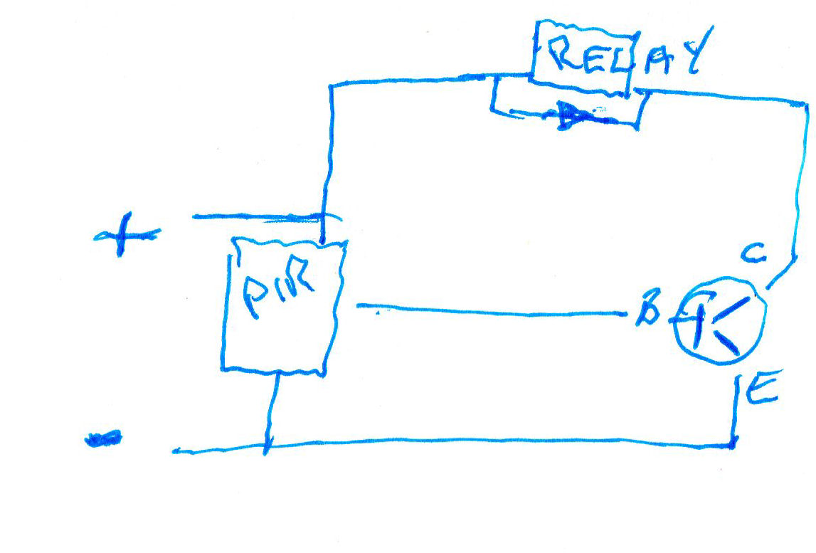

Hi
thanks for your advice, kv is right about a schematic, just to be sure, is this the circuit you are suggesting,
Its just that I'm a pensioner looking for a hobby, not very good yet.

Hi
no prob' kv
As he suggested you'll need a resistor on the base of the Transistor; not to sure what the value would be. The Diode looks correct.
kv
Edit: I spotted a 10k on the base of several circuits using a uC. Which most likely is between 2 and 5v. Should work; but then I'm not an Engineer.

hi Barmy,
Add a series resistor between the 3V output of the PIR and the transistor Base, say 330R.
Do you want a diagram.?
E

One point, I had to take out the diode, (one I found in box of bits, could have been faulty) does this matter, if so can you suggest a replacment,
Thank you both again.
Barmy
A suppression diode across the relay coil is essential, cathode to supply voltage, anode to transistor collector.
