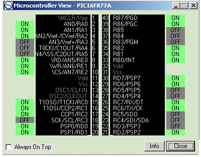

pins 3,4,5 on every port not working
gabeNC
I'm pretty sure this is a rookie mistake but I can't quite figure it out. Even tried the "wizard" in Sourceboost to make sure I wasn't doing anything completely stupid with the ADCON registers. Using a 16F877 and have every pin digital and out (except for RA4), driving a 8x8 RGB array. 8 transistors on the column drivers etc. Just ordered some shift registers for later but for now i'm just learning. Here's the code

Here's what the sim shows.

Edit : Have just noticed somthing that when using binary it is written like this portb=0b111111111;

After your first post I checked that and it was the 0b<value> omission. That's a little embarrassing to miss something like that :eek:.
Kinda weird that the PORTA-E registers were set to C7 without the explicit binary "flag" (see attached pic), maybe I was hoping for a syntax error instead hahaha.
