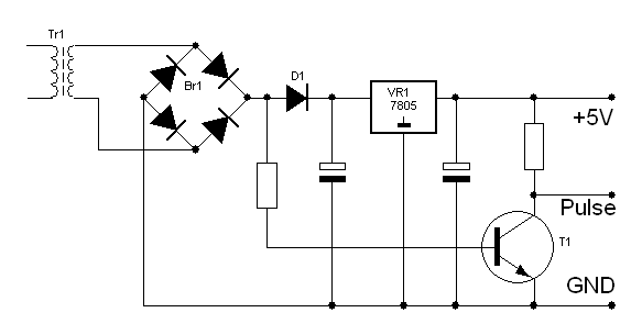

Right, for a zero cross detector - any particular ICs in mind? And what about the associated circuitry?

Yes, you can feed mains directly to a pin via a suitable HIGH value current limiting resistor - there are a number of MicroChip application note showing this.
However, I would prefer to do it after the bridge rectifier - simply place a single diode between the output of the bridge and the electrolytic capacitor. You can then take a feed from the output of the bridge, through a resistor to the base of an NPN transistor - it's collector (pulled high via a resistor to 5V) will have a lovely zero-crossing pulse on it!.
Neither Nigel nor I are suggesting that it be taken directly from the mains. It should be taken from the secondary of a transformer.
I would also include a capacitor from the resistor (at the input to the PIC end) to gnd in order to filter any high frequency spikes that may be in the mains.

I think I am going to give your idea a try, but am a bit confused about the orientation of the diode and from exactly where I can take a feed from the bridge o/p?
OK, here's how it's done!.
