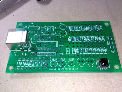

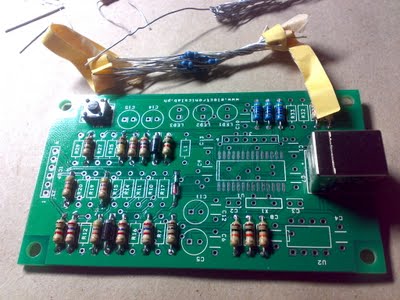

here's my PICKIT2 Clone...:D

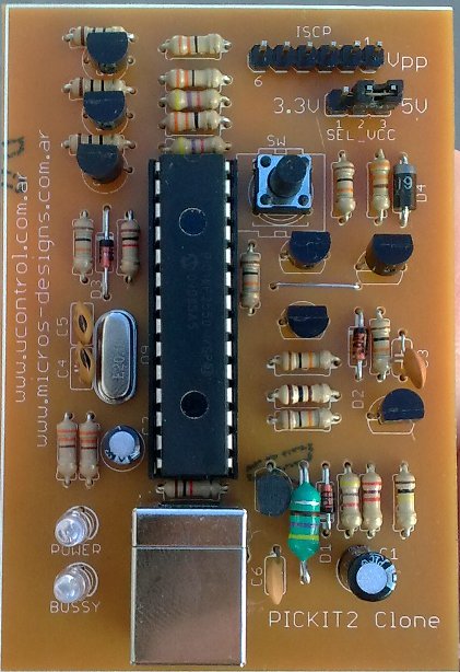

BTW here's another Cloned PICKIT2

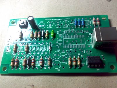

Later made the pickit2 clone of Palma which has the zif socket right on the pcb and works great !!
