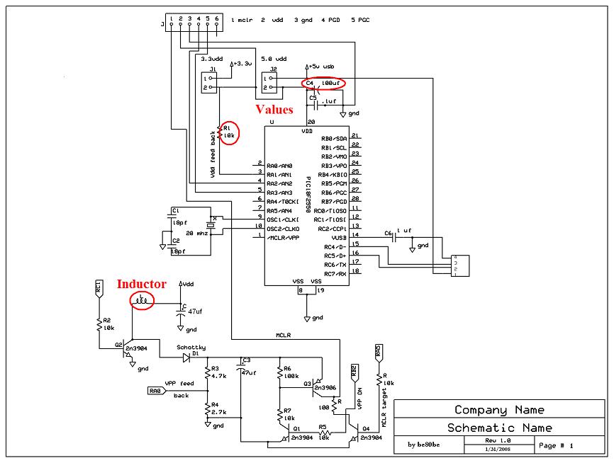

hii i got this pickit2 schematic from some link am planning to build this i just wanted to make sure whether the circuit will work or not? can anybody please check this circuit...

I always found it rather humorous--A PICkit programmer clone that requires an already-programmed chip in the circuit... :D:D:D
Genie Design Studio has produced a PIC programmer that does not need a pre-programamed chip. But it only works with their development board.
Can't see the values in your schematic Bert. Don't see any inductor either?
Do you mean these values and this inductor?

my friend said clone can read and write all the 5v pics...which original one does...if there is any original pickit2 schematic and pcb layout please share here.. i want to build myself .....
If you want to build a full pickit2 clone you may as well buy one. The one I posted you can find all the parts most any where. And I know for a fact it works better then most I built over a 100 programmers. Testing for the best one.
It works fine with any from 480h to 680h. I did forget that but the rest are there. I posted inductor size where the sch is posted.

I dont think your PCB is big enough for a 480H choke....:)
It's uH I forgot the u the ones I use are about a 1/8 long smt parts.
But your right ericgibbs it would be big lol
and the switching period would be around a week ;)
