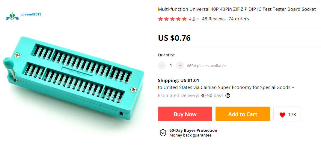

Which is ludicrously cheap (less than half the cost of the ZIF alone from RS Components), comes from the UK, and has free postage - so I ordered one.
If anyone is looking for a cheap ZIF adaptor for their PICKIT then it looks well worth a try.

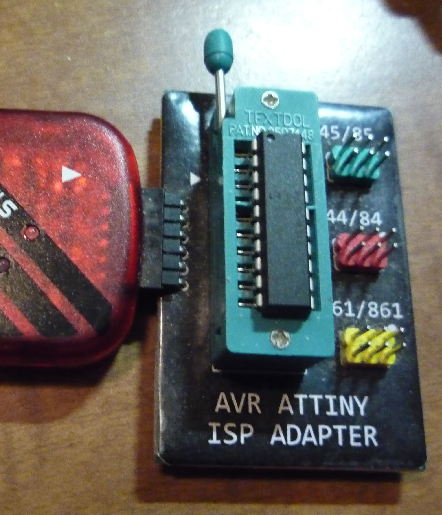

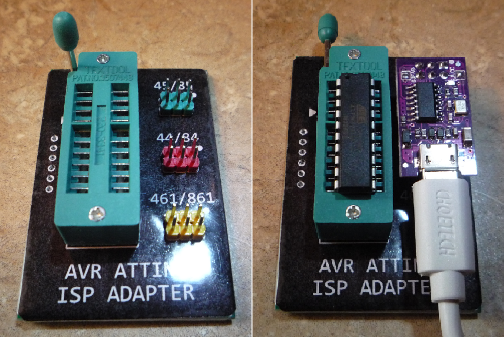

Nigel, I like the first one. I did a ZIF programming adapter something like that for some of the common ATTiny 8, 14, and 20 pin chips... And since all of the 8/14/20 pin PICs use the same programming pins, I added a connector and the wiring to program them with my PICKIT 3...
I can't wait to see what you come up with...
Take care & stay safe... Cheerful regards, Mike
I purchased six of these over a year ago when shipping was still free... they're really not bad quality...

That's really nice, beautiful dual purpose board - good idea :D
You must have had a 'eureka moment'!
Nice purchase on the cheap ZIF sockets as well.
