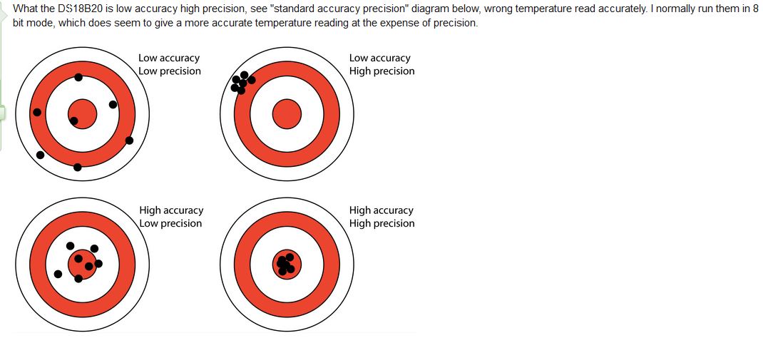

As other say, see below, the Ds18b20 is a Low Accuracy High Precision device , so your averaging may not provide the accuracy you need ?
Have generally run them in 11 or 12 bit mode, so no idea if running them in 8 bit mode does give better accuracy as that author states ?
Seem the RDT is the most Accurate, but again as the pdf shows its all about trade offs, dependent on your needs ?
The biggest problem when talking about 0.1c or 0.2c accuracy is finding a reference to work against, freezing or boiling points sound obvious but not very precise to use in diy terms.
Generally use a calibrated analogue thermometer with a quoted 0.2C accuracy as my reference point, or if you are lucky, access to some lab equipment.
