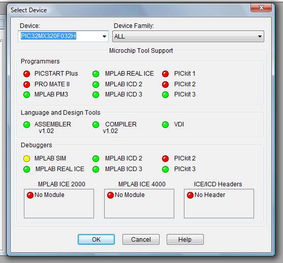

According to MPLAB, you cannot program or debug this chip with a PicKit 2 but YMMV.

When in doubt I always have a look MPLAb 8.63

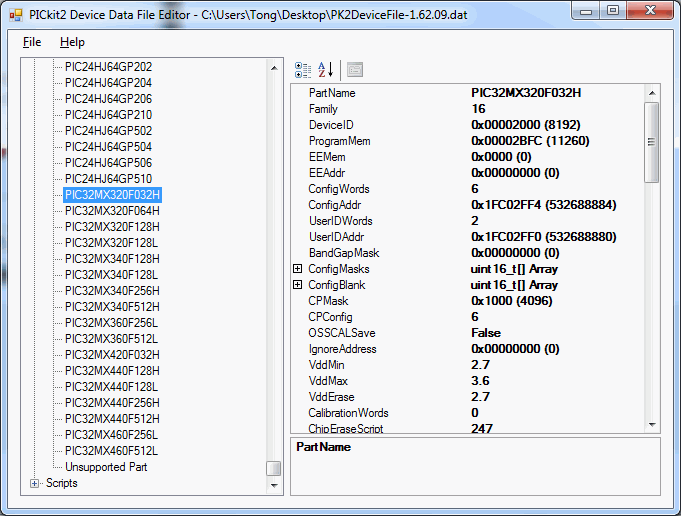

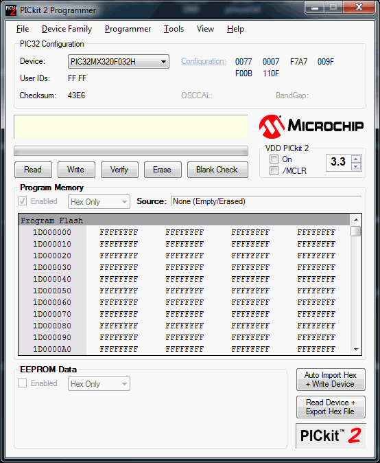

That chip is in the pickit2 device file used by the standalone pickit programmer application. You should therefore be able to program it using the pickit 2 without any problems.
