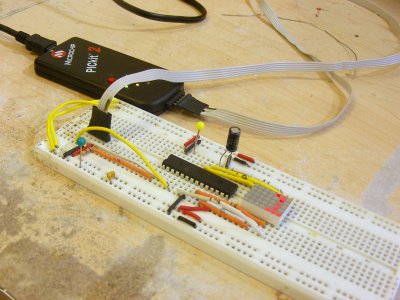

My 24F series dev board. Sames as my every think else dev board :)
If you are using Veroboard, it is very simple to wire some pins for plugging in the PICkit2.
Pins 1, 4 and 5 of both the PICkit2 and the PIC24FJ64GA002 are MCLR, PGD and PGC. It makes wiring them up very simple.
Pin 6 on the PICkit2 isn't used and 2 and 3 are Power and Ground.
You can run small circuits from the PICkit2.

Sorry for a thread-jack, but donniedj what is your programming cable made of? Standard ribbon cable and some kind of connector? Looks very neat, I wouldn't mind making one like it.
