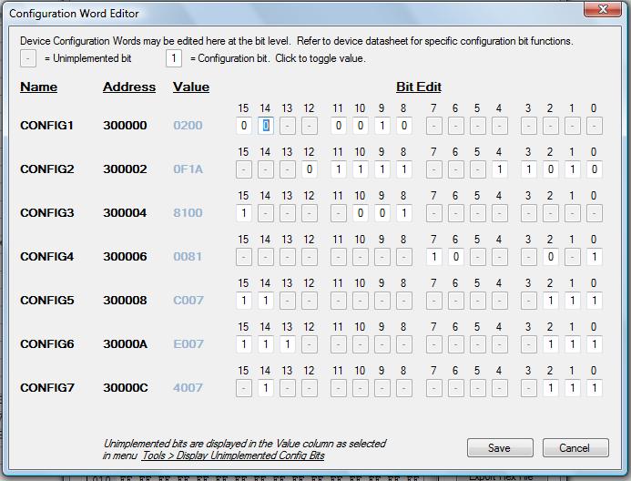

I am building laser tag guns that I found on a website. I have constructed the circuits, but now I need to program the PIC's with the provided hex file.

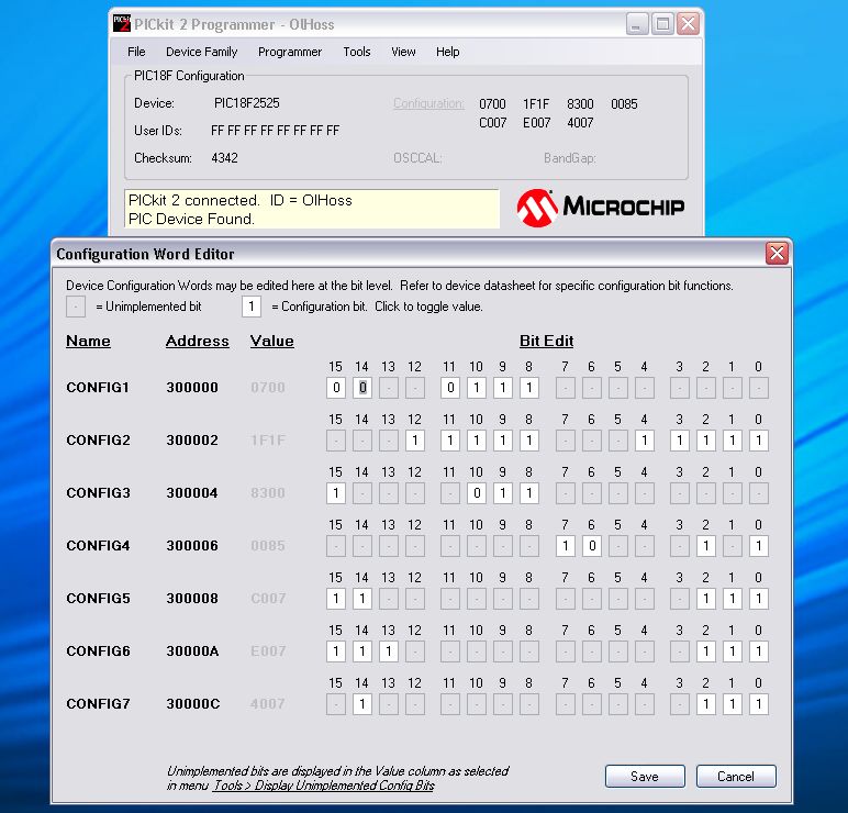

I have a problem though, the hex file does not include the config word, so I need to enter it manually. The website provides the config settings for different software than the PICKIT2 programer application which I am using. Is there a way to convert these settings into a PICKIT2 config word?

Maybe this will help you they should be right
CONFIG1H   :$300001 : 0x0002
CONFIG2L   :$300002 : 0x001F
CONFIG2H   :$300003 : 0x000E
CONFIG3H   :$300005 : 0x0001
CONFIG4L   :$300006 : 0x0081
CONFIG5L   :$300008 : 0x0007
CONFIG5H   :$300009 : 0x00C0
CONFIG6L   :$30000A : 0x0007
CONFIG6H   :$30000B : 0x00E0
CONFIG7L   :$30000C : 0x0007
CONFIG7H   :$30000D : 0x0040

Here try this it should be ok
I did this 3 times I just manual set the config but the hex is a lot smaller 43 bytes that's funny
You can load the hex you have it works fine it don't have all them set but it has what you need
I would use the Hex you have
Here you can try it you have the right chip just set them with the PICKIT2
I removed the hex just set like in the pic
