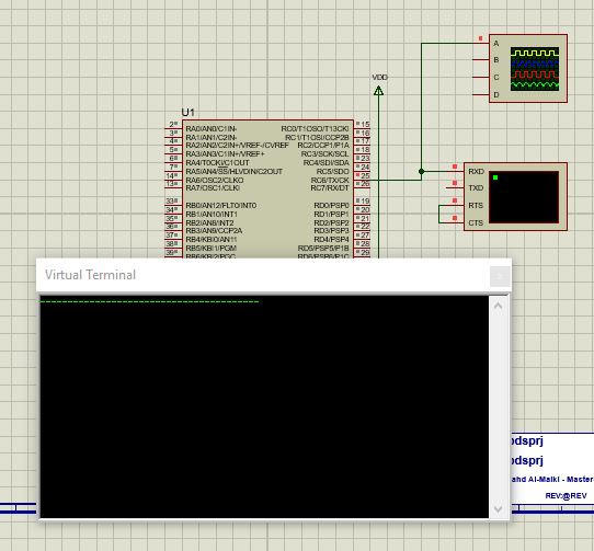

I am using the PIC18F4520 on Proteus 8. I want to use the USART to display the 'U' character all the time on the virtual terminal.
The baud rate is 19200 and I changed it on the virtual terminal as it was displaying wrong characters to baud rate set as 9600 (default).
I am getting 4 dashes at a time ----- instead of Us. See attached.
Can you help and explain why I am getting this? Or give a hint or point to the part in the source code that is causing it to do this?

Hi Mike. Thanks for your reply. This is making me pull my hair. :(
How do you check which one of these scenarios is causing this?

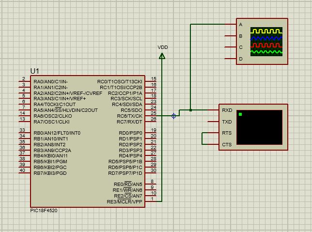

First do a blinking led to check if it's running at 20MHz and maybe use a scope to check the RS232. Also, have you checked the polarity? Do you need a max232?
No! Proteus terminal is TTL..
You don't mention a crystal or crystal resonator. What frequency is your crystal/resonator?

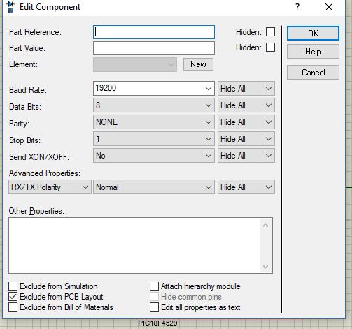

As for the virtual window. I thought of that as well . I have changed it. take a look at the screenshot.
I know I need to calculate the baud rate using the formula and I get 64 for 20MHz oscillator and 19200 baud.

I have asked my tutors and they don't seem to know. the configuration for the Oscillator is HS which means I am using a crystal. Now, I have completed all my previous labs such as ADC and what not, BUT I have never interfaced the crystal circuit with the OSC1 and OSC2 pins on the PIC18F4520 and it worked . Can you explain that please?
To answer your question; yes, the frequency of the oscillator should be 20 MHz. I have used the formula to calculate the SPBRG value based on that (64).
jpanhalt and Pommie
Protues is a simulator that doesn't use oscillators, what I mean is they are not modelled, all you need is to specify the speed you wish in a properties dialogue..
I'm assuming this was the problem judging by the response... The dialogue defaults to 4MHz...
At least you are up and running!!
Got it Ian. Thanks mate. I kind of guessed it. But I have seen online projects and exercises on youtube, forums and other MCU websites that they do interface them. So is that redundant (because they don't need to)?
