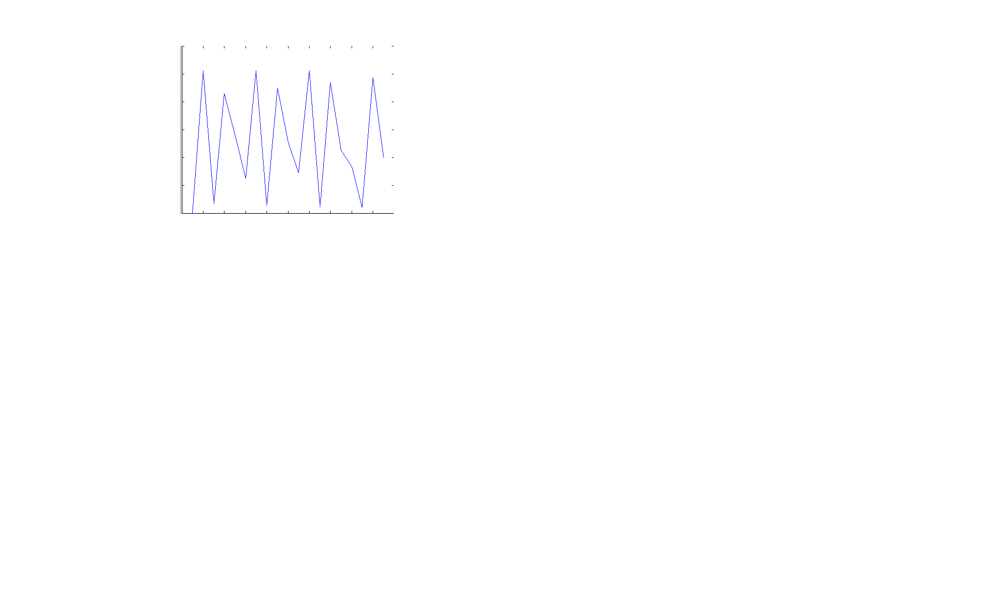

here is my aliased sine wave :( is attached
I have already pass my signal through clamper and then anti-aliasing filter..
But what i think so that problem is with MCU frequency clock ..When I changes it to 150 Mhz:confused: so signals becomes much better but it is too high ..
Please guide...

What range of input frequencies are you working with.??
Also can you post a diagram for clamp and anti alias filter.?
Do you realise that you are only reading 10 samples per second? If you are sampling 50Hz then you need to be reading the ADC at a much higher rate.
Edit, just looked at your code again and you're reading at about 2 samples per second.

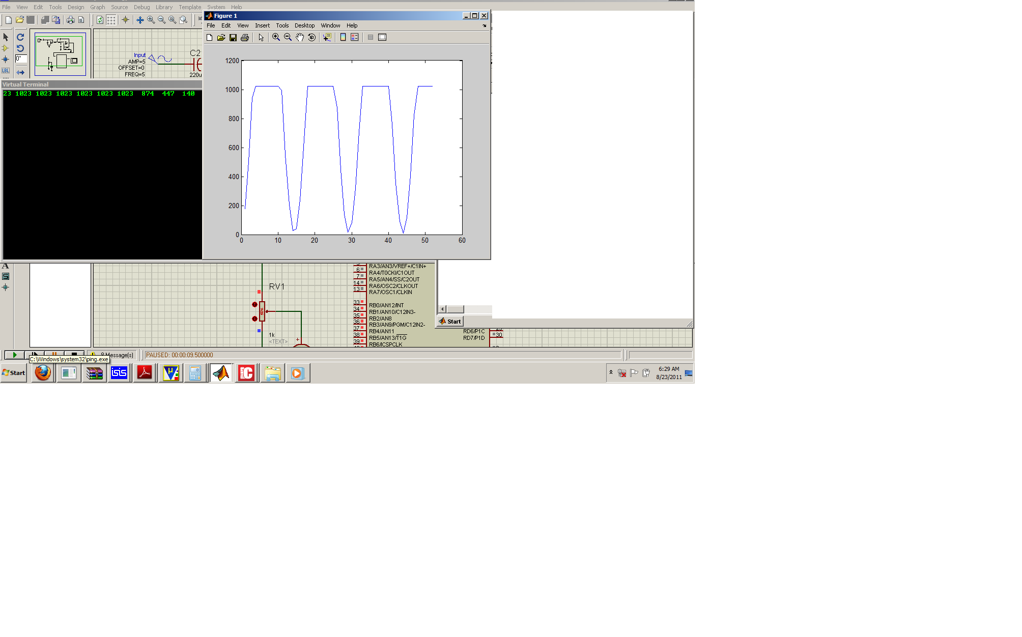

hmmm, Something different but it is not sine.. huh.. .. :(
That is a very clipped waveform. It looks like the AC that you are feeding the chip is greater than 5V.

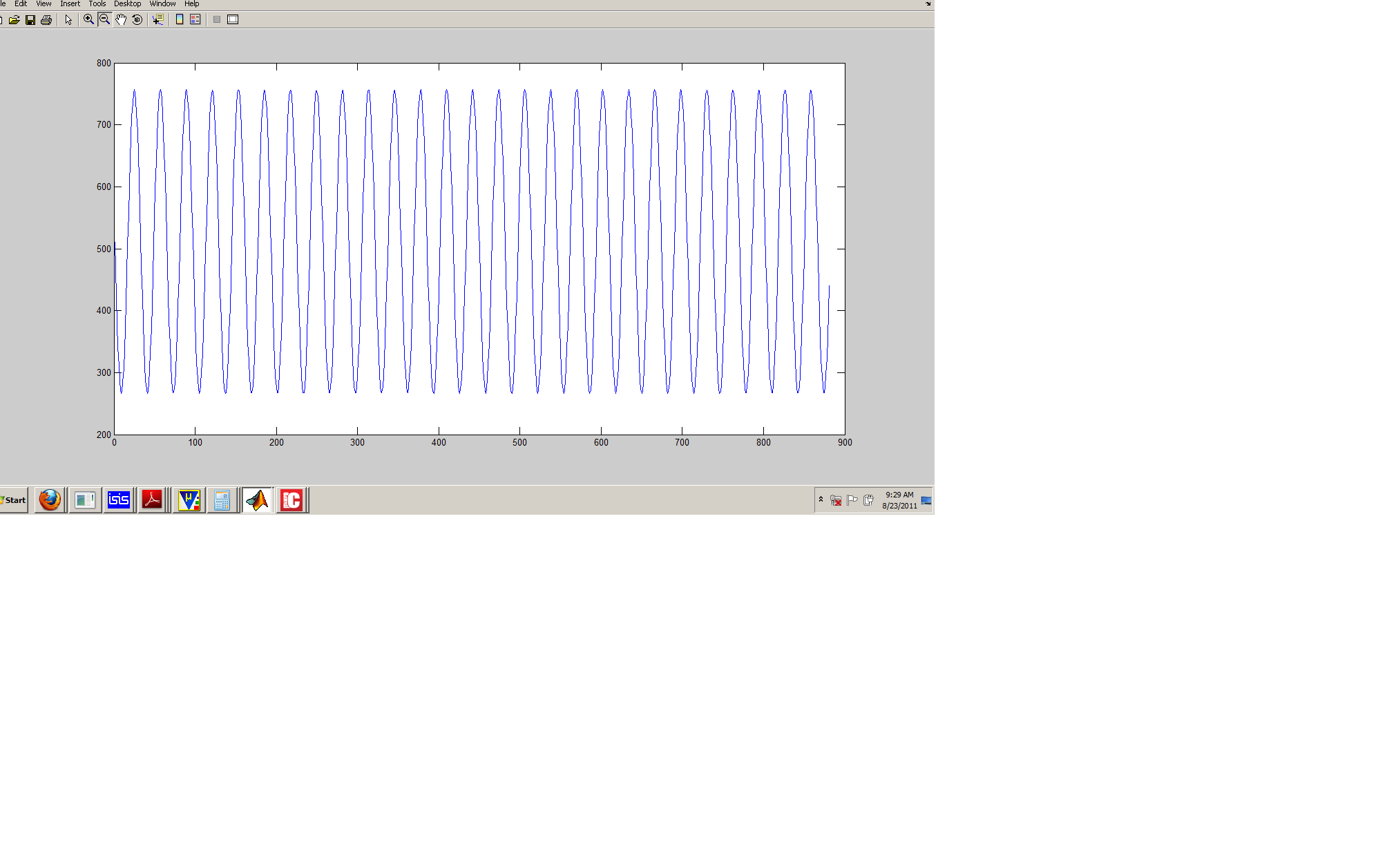

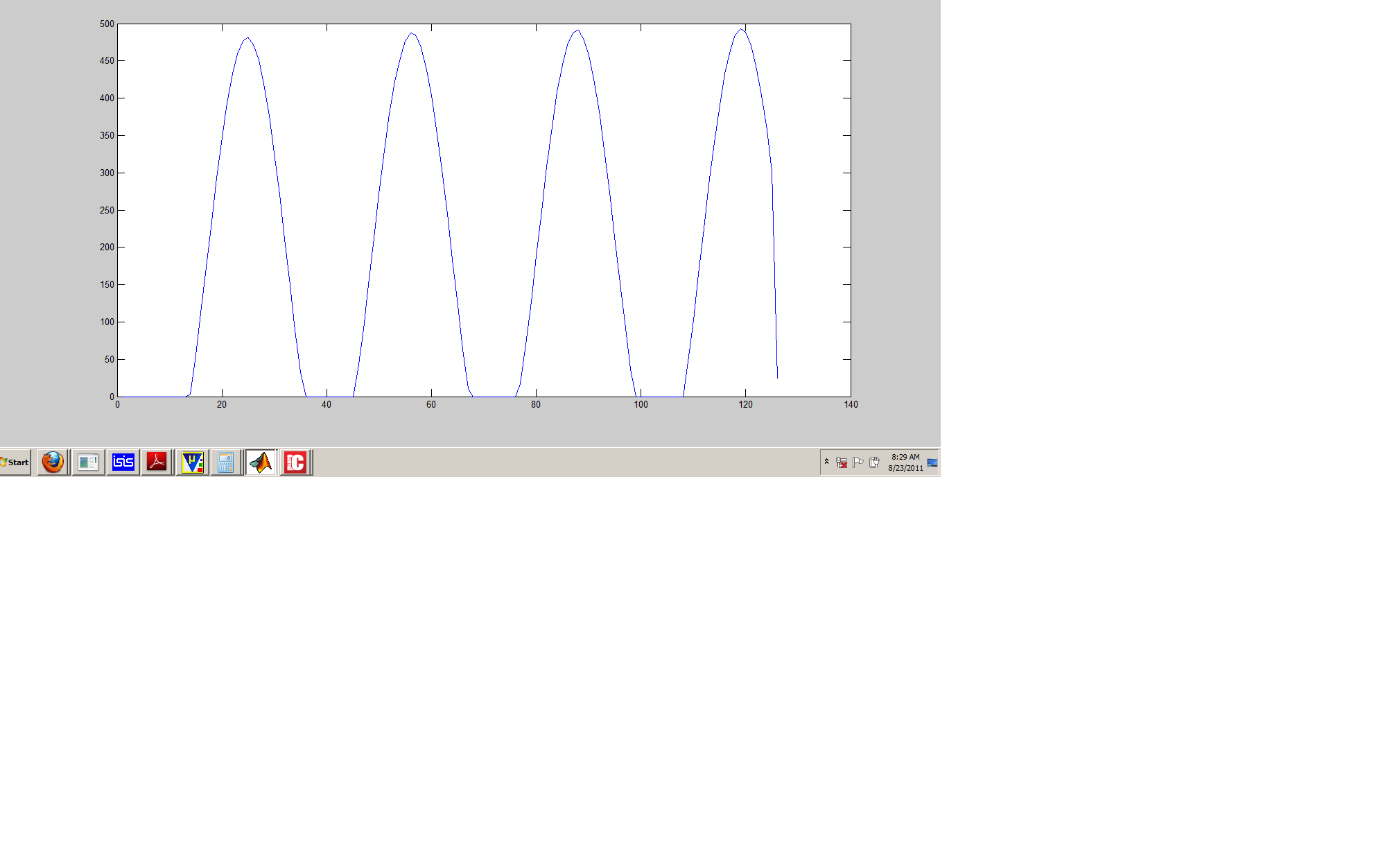

okay,, Thanks Alot... See my waveform I think it is good now... ? :D
But i think it is still not clamping correctly ..

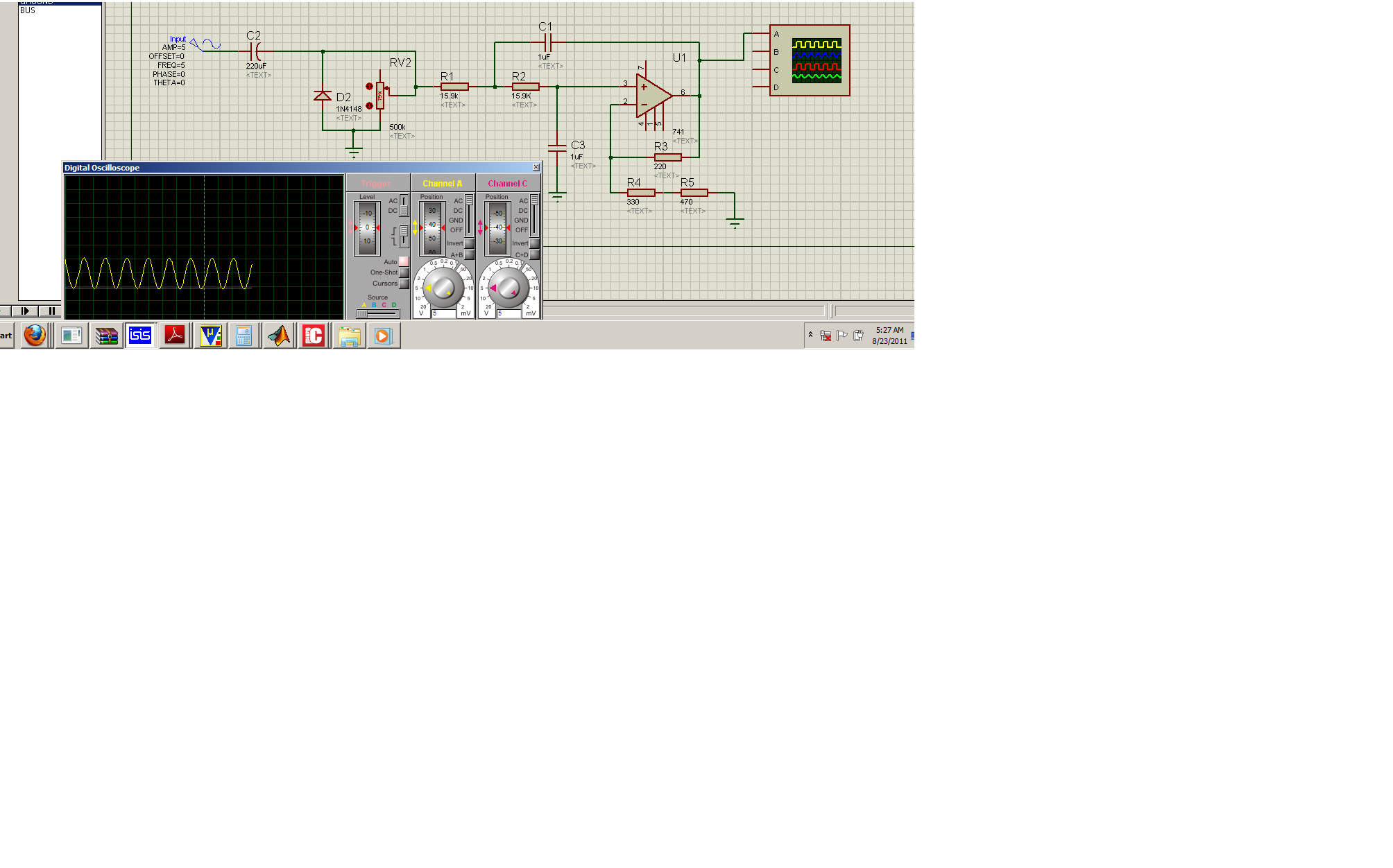

Now, I just changed the clamping circuit...:)
Input is 2.4 V Amplitude Sinewave
