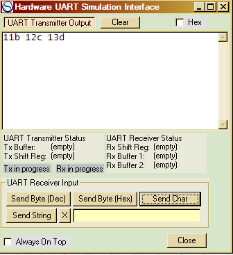

This program works OK in Oshonsoft.
If I transmit the first character as '1' [ascii] and the second character also '1' [ascii], after adding I get 0x62 , in Wreg which when sent back to the PC as a transmitted character, I see 'b' [ 0x62 ,, decimal 98] which is correct.

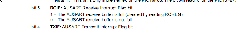

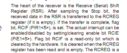

Eric you ignored what I said! 1 + 1 will work but 1 + 2 will not for example, it would give you 1 + 1 (repeat of the first character) It's important to clear the RXIF, it's not done in hardware!
hi Boo,
Reading movf RCREG,W clears the RXD register, try running the program.
The TX/RX intr have not been enabled.
EDIT:
Modified the program just to echo the PC to PIC characters and the summed response.
