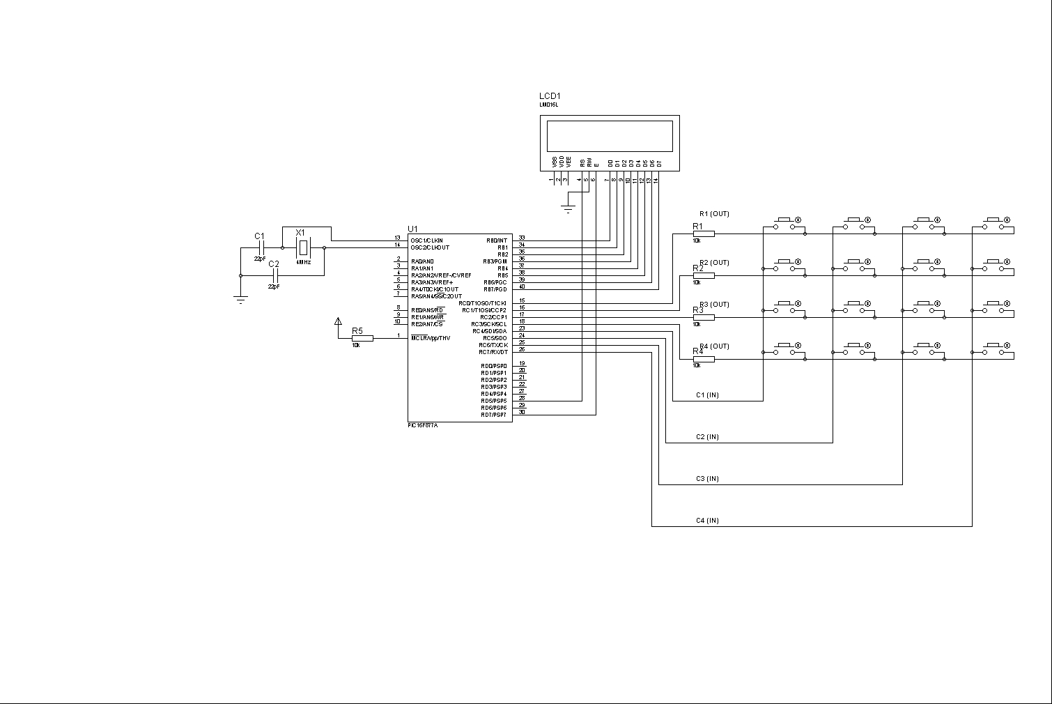

Hi all,
I am very thankful to Mr. CC Dharmani for his code written for ATMEGA16 using winavr
I have modified some parts of the code for making it compatible with PIC16F877A.It provides keypad and LCD interfacing with PIC MCU the link of original code developer is given below
Design with Microcontrollers: 4x4 Matrix Key-board Interfacing with ATmega32
C:
// ******** 4X4 MATRIX KEY-BOARD INTERFACING ***********
// ORIGINAL CODE FOR ATmega16 BY CC Dharmani
// MODIFIED FOR PIC16F877A BY MEHMOOD AHMED,Karachi,Pakistan
// Note: Minor changes in original code have been done
//		 for PIC MCU
//Controller:	PIC16F877A at 4MHz
//Compiler:		HITECH-C
//Date:			May 18,2011
#include <pic.h>

__CONFIG( WDTDIS & PWRTEN & UNPROTECT \
  & UNPROTECT & BORDIS);
#define FOSC 4000000
#define	_delay_us(x) { unsigned char us; \
		       us = (x)/(12000000/FOSC)|1; \
		       while(--us != 0) continue; }

#define KB_PORT_OUT 			PORTC
#define KB_PORT_IN				PORTC
void port_init(void)
 TRISB  = 0x00;
 PORTB = 0x00;
 TRISC  = 0xf0;//Key-board port, higer nibble - input, lower nibble - output
 PORTC = 0xff;
 TRISD  = 0x0f;
 PORTD = 0x00;

thanks. but what if i want it to be 3x4 matric keypad? what should i change? from the program i mean, removing the C4 (in) from the circuits.
