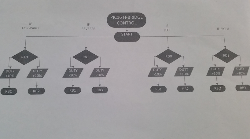

Hello everyone, I am rather new to programming and wanting to get general help.
The aim of my project is to make a Dual H - Bridge motor controller CODE with a L293Chip. Which is going to be used to control a "Aqua Drone" on the water. There will be 2 motors, which spin together, or individually depending which direction is chosen to go ( left motor spins = turns right , right motor spins = turns left , both motors spin = straight). For now only those 3 functions are needed to work ( im aware that you can also make them spin in different directions).

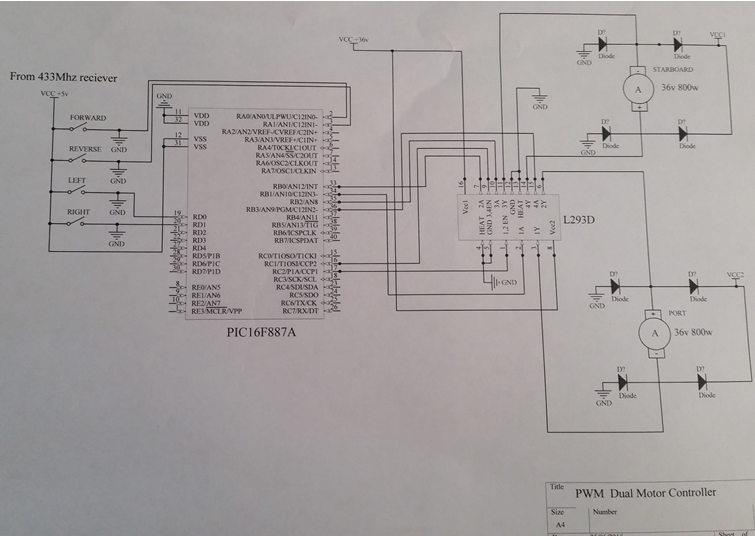

Electronically, i have connected everything for the L293, even made my own 433Mhz Wireless controllers to activate the motors (using the activation pins). The circuit works with the mechanic/electronic activation , however i am wanting to include a PIC16F877A chip to do the logic of activating the L293 chip and its motors for personal development.
Basic action i am wanting the PIC16877a to do (mplab 8.70), is to first recognize the wireless receivers inputs to the PIC (from the transmitter on the remote control, https://www.globalsources.com/gsol/I/RF-module/p/sm/1108582354.htm#1108582354 ). Once those inputs are activated on the PIC , using IF statements (and other? ) in the code - 2 out puts can be activated 1 at a time ( or 2 at a time in order to get both motors spinning.) So this will need 2 bits of code, assuming both the inputs can be held high at the same time to get both outputs going (ultimately powering on both motors at the same time). Those 2 PIC outputs would be connected to the L293 activation pins (any of the 2 from - pin 2 , 7, 15 or 10 ), so for example R01 is pressed the output will be R05 ( i dont know that the output pins could be ) so the left motor spins, when R02 is pressed the R04 goes high and the right motor spins, when both R01 and R02 are pressed then R04 and R05 are both active giving signal for both motors to spin.
ATTACHED FILE - The diagram presents a concept of how it could work , but ive decided not to use the PWM method as there is no need, so just left right and both at the same time method is fine ( as long as it spins ! haha ) . The digram presents simple function of how PWM is desired to work but i think that would be too much for me at this stage !
So yes, i want either 1 output or 2 outputs at the same time going in order to get the motors spinning to steer the Aqua Drone (boat) into desired direction.

If each motor is only going in one direction why do you need a H bridge? let alone 2? Why not just use a single mosfet on each motor?
Haha, well if you are wondering just why i didnt use a mosfet then its because i chose to use a single IC that can do the same job i guess ( it has enable pins as well and i dont have to use diodes for it and could use a single heatsink ) ? L293 is a single IC which is conviniet and saves space. I Could have also used any transistor at the cost of 10 cents probably. PROBLEM IS that i want to use some programming in order to control it , for the sake of learning programming. Any suggestions? Thanks.

A quick google found This Page. All you need to change is to wire the enable to RB2 and then wire your second 293 to some other pins.
Edit, if you have the L293 instead of the L293D then you will need flyback diodes as they are not on the chip.
Hello, thanks for reminding me Pommie . I think its the L293D (will check). So far i edited Saeeds code from his google blog. Could someone tell me if this could work for 2 input and 2 outputs ( as well as simultaneous input ). I am really a beginner so please tell me with /comments what to edit! thanks.

Pommie , thanks for that tutorial! It is actually what i really need (ideally), will get to that at later stage once i can get the simple one to run! Thanks :)
Here is the Successfully Compiled/Built code. What do you think?

Here is the code that deals with the PWM. (I think this is all you need to look at but it is 7 years since I wrote the code.)

This is the link to the file in my Dropbox folder.
The zip file contains the schematic, the main .asm file and PC.inc
You do not need to look at PC.inc as all it does is deal with serial input and output for setting up the PID constants. (Proportional gain, integral gain and derivative gain.)
This is the design for the X axis table feed on my milling machine that I made in 2008
