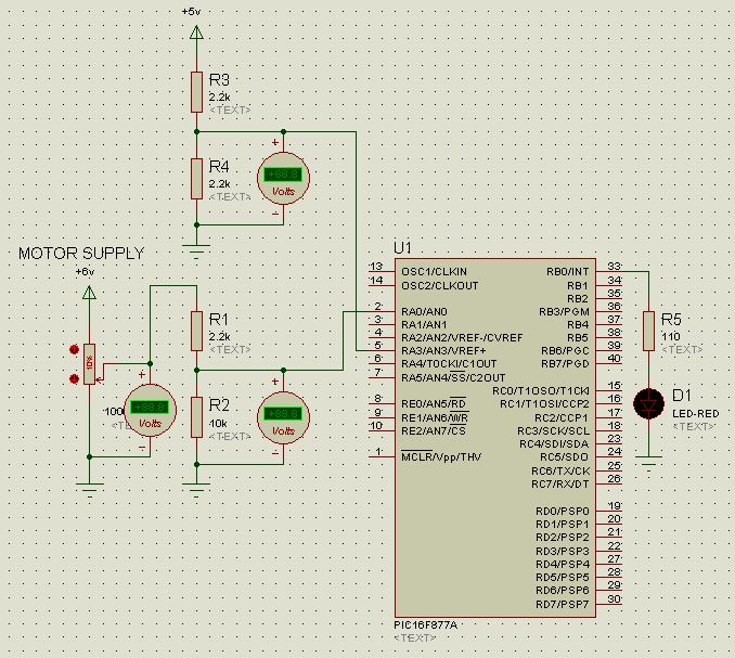

Hi, my program about comparator interrupt has a problem. Can you help me with this one? The circuit below is a battery low voltage indicator. I think ISR is activated but it is always triggered. In my program, portb.f0's state should be inverted as soon as the voltage CMCON.C1OUT state is changed. Can you check my program? Here's my code:

I attached my schematic below. I hope you can help me.

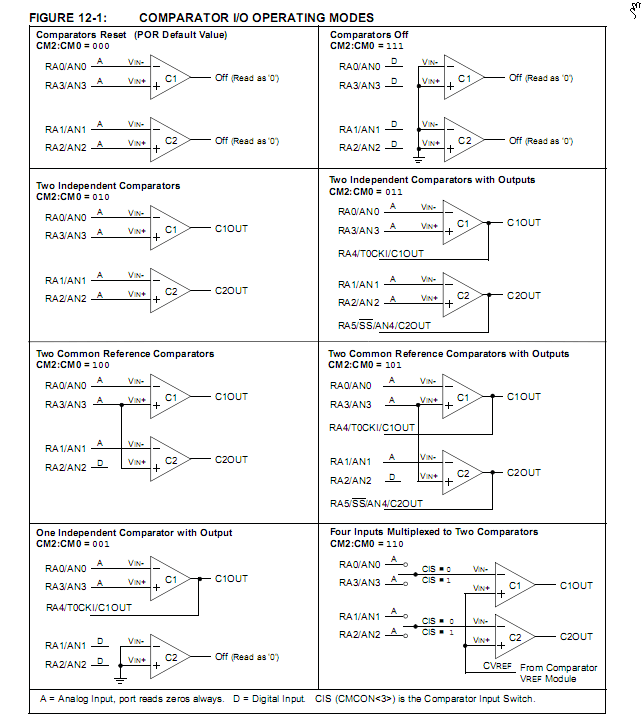

Check your CMCON settings.
You have both comparators enabled. The other comparator will be oscillating and causing the interrupt.
