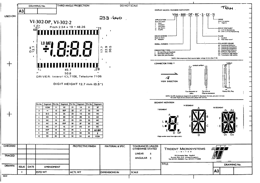

You need to know what type of LCD it is. The Pins it has and the controller it uses to write code for it and to wire it.
Otherwise its like being blind and someone asking you is the light red?
