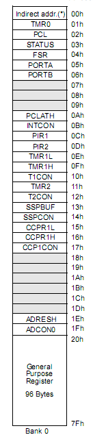

The PIC uses registers 0x00 thru 0x1F for its internal use, the general purpose free registers for the user start at 0x20 [20h]

Look at the image for the registers.
Always get a datasheet for the PIC you are working on.

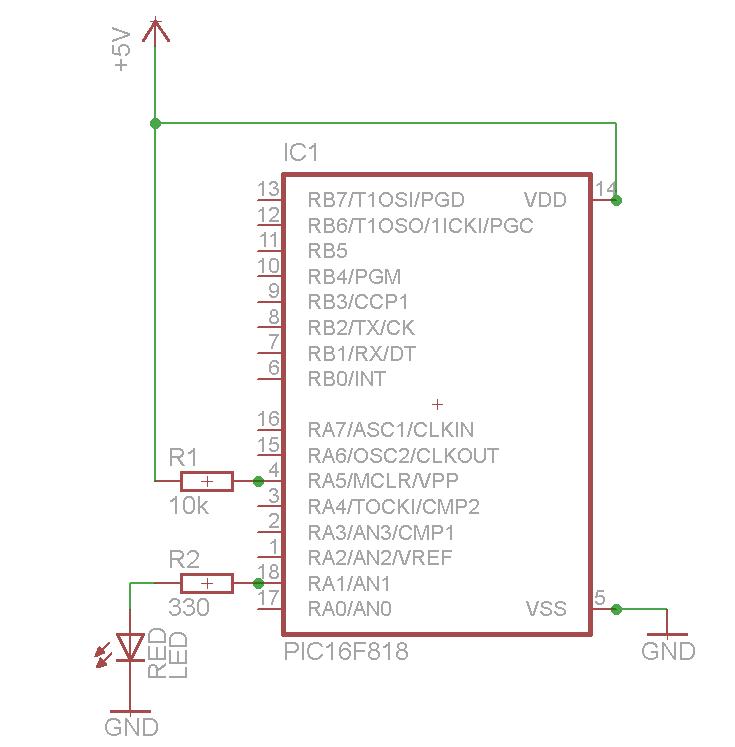

BTW, its still not working I will post my circuit i am using
Hmm thanks for the explaination I like it!!!!!!!
Thats because you are switching pin 18 in your program, not 17.!

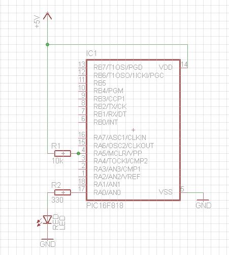

Here is the update of my schematic thanks eric for spotting that out.
Here is what happen When i turn the power supply on the LED lights on and keep lighting on.
BTW, if you can help me thanks again :)
Still not working!!!

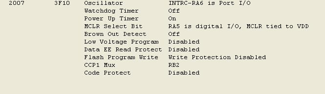

Check the config.
Rechecking.
EDIT:
bit 5 is low so MCLR is internal, you have a resistor attached.
this shouldnt cause a problem.
I print screen my config so you can have a look into it
Thanks for replying :)
