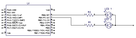

Hello everyone, i am seriously in need of your help. I've got a project on PIC16F627A that i should submit in two days time. Well if i had an idea of what was going on with this, i wouldn't have asked for help... thanks to our useless lecturer.
Here are the projects specifications, please help, anyone?

Tumelo... Are you prepared to put some effort in ? what do you know / understand about PIC mcu ? do you have a basic electronic ( Ohms Volts Amps ) knowledge , if so start here ..... add in some voltage connections / values ... etc

The way I read it is..
Two LED's connected to RB0 and RB1.....
Set the LED's to blink ( at a rate set by you )
Whilst RB0 is blinking, RB1 should be off..
Whilst RB1 is blinking, RB0 should be off..
The blink rate should be slow enough to be visible but fast enough to see that its blinking..
I would set the blink to 5 times a second!!!
As Nigel has already said... All the code is on his tutorial page ( the pic16f628a is a pic16f627a with twice the program memory so the code will be fine...)
Are you going to use negative logic as required in the diagram above or be sensible and use positive logic ??????
This is the text of the task....
Please note this Practical is due Tuesday 15 September for practical group 1, failing to submit can and will lead to subtraction in marks.
Design a system that will blink two LEDS for 1 seconds using PIC16F627A.
Electrical connections
Connect LED1 to RB0
Connect LED2 to RB1
PIC16F627A
The circuit operates like this:
When the power is ON LED at RB0 it should blink for 1 second, The LED at RB1 is OFF while the LED at RB0 is blinking.
When the LED at RB1 is blinking, the LED at RB0 is OFF.
Tasks
Draw a fully labeled diagram of the circuit explained above.
Develop a flowchart to indicate how your program will execute.
Demo your project and submit the document together with the mark sheet attached to this assignment

Hello everyone, thank you for your replies, i am getting somewhere. Fins attached below my code. The LED's are blinking, problem now lies with this 1 sec, the lecturer told us we should calculate 1 sec, which ofcourse i don't know. My other problem is i get an error message after few minutes of simulating my code. The error states "Stack overflow hardware" something like that. I can't fix it; i still have to connect it on the bread broard. HERE IS MY CODE: Please advise me.
fx equ h'20'
org 0
bsf 3,5
movlw 40h
movwf 86
bcf 3,5
delay movlw 161
movwf fx
main
bsf 6,0
bcf 6,0
bsf 6,1
bcf 6,1
call delay
goto main
end ;END OF THE PROGRAM

There are many resources for calculating loop constants to generate a delay. Here is a popular one:
I entered an assumed oscillator frequency of 4 MHz, and here is what you get for a 1 sec delay:

I am not sure that simple approach will help you, as you have to be flashing an LED for the for the 1 second delay period. On the other hand, if you flash at, say 6 times per second, you can just add a counter (n=6) and when that expires, switch the output pin and continue the flashing routine. There are, of course, other ways to skin this cat.
John
Sir Jpanhalt, how and where do i put the code in conjuction with my source code... it gives me some errors.
