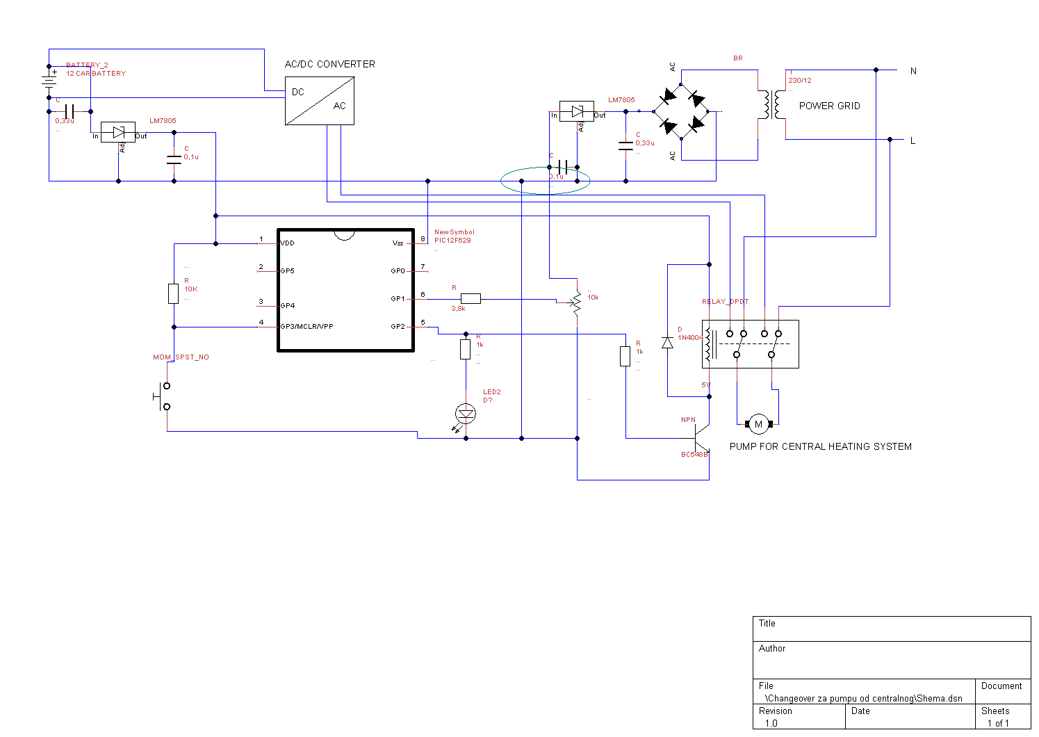

Hello,
I have made circuit board (schema is in attachment). It works like this:
  1. When the voltage from the power grid is present pump for central heating system is powered from the grid. It uses N/C contacts on 5V relay.
  2. When voltage from power grid is not present, PIC12F629 turn on 5V relay and in this case the pump is powered with DC/AC converter. When the power from power grid restores, pump is powered over power grid again
I have write several lines of C code for PIC12F629 and everything works except one thing, I have made mistake somowhere and I need help from you to see where I have made an error.
When the PIC turns on relay everything is OK, on relay coil there is 4,7 V and LED is ON, but when I turn on power from power grid I can hear that relay is OFF and LED emits very low level of light. There is 0,5 V on relay coil. Please look attachment. I have to connect 0 V from 7805 from car battery to 0 V from 7805 from transformer.
How can I solve this situtation?
thanks
You have the 7805 on the right backwards.
Edit, you also haven't said what the problem is. It sounds like it's working correctly.
Thanks Mike,
it is only mistake only on schema, I have connected it in good way on my protoboard,
There should be nearly nothing across the relay when its de-energised.
Does your code drive the output pin for the relay to 0, or does it go high impedance?
Try a 10k from base to emmitter on the transistor to ensure it turns off.
Also put an led on the output of the mains powered dc supply, the mains transformer will be happier with a little load on it rather than just the 10k.
If the LED is lighting at all then the pic pin must be going high for a short period. The 0.5V you are seeing is the average voltage, can you use a scope to look at it? Also, the lack of decoupling capacitors and powering the relay through the 7805 could be causing a continual reset. Can you power the relay from the 12V supply?
Edit, you might want to post your code as the problem might be there.
just a quick one - did you disable the comparator?
I don not have scope now. I have changed 5V relay with 12V and I have the same problem (with 12V relay and voltage from the grid, I have 1,2 V on relay in off state.
/* Project name:
     Detect low voltage
* Description:
     When voltage is detected LED blinks
* Test configuration:
     MCU:             PIC12F629
     Dev.Board:       EasyPIC4
     Oscillator:      04.0000 MHz, Internal
     SW:              mikroC PRO for PIC
unsigned char i;
bit oldstate;                       // Old state flag
void main() {
OSCCAL = 0b11111101;                   // calibrate internal osilator 4 MHz
CMCON = 0b00000100;                 // CIN- analog, Internal VRef
TRISIO = 0b00000010;                     // gp2 = output
VRCON  = 0b10101111;                   // sets Vref
gpio.F2 = 0;
do {
     if (CMCON.COUT == 1)
        gpio.F2 = 1;
             else
        gpio.F2 = 0;
    }  while(1);
No I use comparator to "read" if the voltage from grid is present or not
Try clearing GPIO before you change triss and if that fixes it then your pic is resetting.
