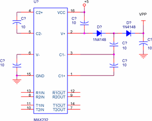

PIC VPP 13v how much current?
William At MyBlueRoom said:
1. What is the minimum and maximum VPP?
in manual it is said that 13+/-0.5
2. are the 16Fxx & 18Fxxx the same VPP voltage?
donno
3. How much current at 13v does the PIC require to be programmed?
very little/insignificant. it is just to enter the programming mode , power is from vcc only
1. Manual states Vdd+3.5 to 13.5 (for 16 Series)
2. Nearly. Manual states Vdd+4 to 12.5 (for 18 Series)
Both of the above can be as low as 2V for low voltage programming.
3. Very little on newer chips.
The above is only general and you should check the data sheet. All of the programming specs are available as separate data sheets from microchip.
yes, newer PICs use an insignificant amount (FLASH-based PICs), it is nothing but a high-impedance input, and Vpp just has to be above some threshold voltage to indicate programming mode. I don't know for sure, but I seem to remember hearing the older PICs used the 13v directly as part of programming the memory, thus the added current draw.
There are some programmers that are USB bus-powered and use a simple capacitor charge-pump voltage tripler to get 13v, and usually they specify that it can only do FLASH PICs, because of the lower current draw (such small charge-pumps are only capable of supplying just a few mA)
Wow thanks all for the quick responses, I'm trying to steal power from a MAX232 chips (with 10uf caps for a little more ooomph).
I've added a half wave doubler (thanks to an app note from maxim #669) to the V+ & C2+ and get just a little less than 18v using 1N4148 diodes. I'm looking into using the C2- and V- to convert it into full wave but not sure if I need the extra current. I only want to program newer F series chips, maybe the 16F84 classic would be a good older chip to try it on. Not sure how much current the MAX232 will supply but it's worth a shot.
A 13v zener should do the trick, I needed to know the current to calculate the series resistor.
The data sheet for the 18F chips states 300uA for Vpp current and 10mA for Vdd.

Hmm I wonder why everyone uses 13 instead of 12? Is it for the older chips?
I could make a simple 1.5x multiplier and with the 1N4148 diodes it's about 13.5v I could switch in an extra diode or two to bring it down to 12 for the 18F series .
Yup another ICD2 Clone... with a 5v supply...
Great, that's easy. I can get 1 to 2 ma without effort.

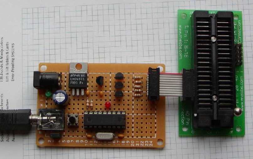

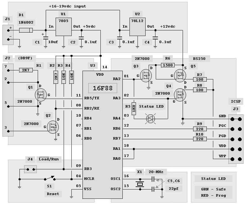

For reference, I've built three programmers using hardware similar to that below (16F88, 18F258, and 18F2320 versions).
Regards, Mike

Looks nice, do you have it released on a website?.
I don't see any reason for your problem with Vdd first?, unless you're sending seperate RS232 messages to do the switching?, that would probably be too slow for devices with internal oscillators?.
I have not released the design. I built it to help the folks at melabs find a problem on their serial programmer. The VDD and VPP drivers are virtually identical to theirs and I was able to help them by finding an error in the DS39622 document that prevented '2620 and other devices from erasing properly.
I'm controlling the VDD and VPP switching in firmware on the programmer with 200-nsec resolution. Much finer control than I suspect you have by setting or clearing bits on the parallel port from a PC app'.
Perhaps you're "lucky" or you just don't have experience with devices that truly require the "VPP first" method. Or, perhaps there's a problem with my hardware/firmware/software. Time will tell and I'll certainly come back here with apologies when/if I find a problem (grin). Meanwhile, I'm going to assume there's a reason for the spec', since that's the only way if works on some devices for me.
Take care. Have fun. Kind regards, Mike
Mike, in your schematic the ICP pinout is from top to bottom
GND
PGC
PGD
VDD
VPP
I use
VPP
VDD
GND
PGD
PGC
Is there a standard you know of?
Please pick one; (A) No real standards I'm aware of. Or, (B) Everyone has their own standard (grin).
I used a pinout that matches the melabs serial and usb programmers so that I could use my melabs programming adapter board.
