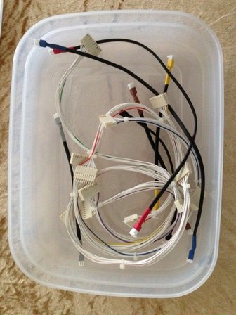

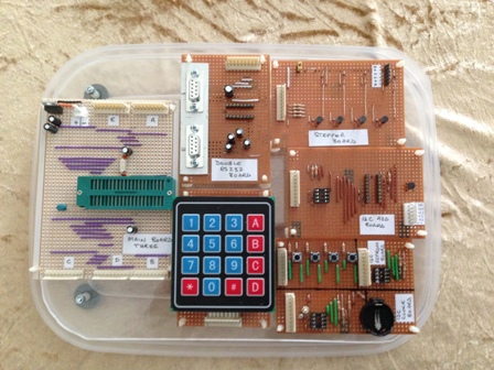

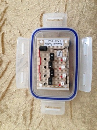

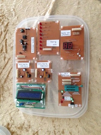

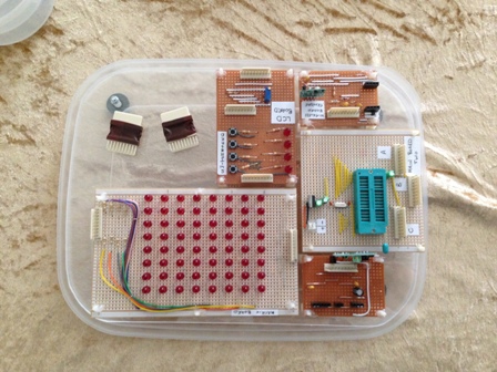

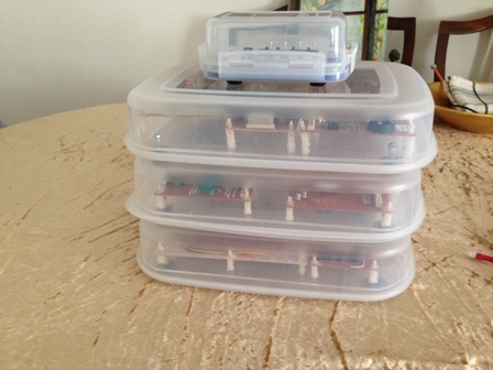

As you know, I've been threatening for some time to complete NG's WinPIC Tutorials and in order to do so there is a total of 19 development boards to be built for practice purposes. Following on from completion of the task, I would like to do the same with C, and IR's tutorials use the same the boards but speak different :)
I decided to take a little time and build the things properly, so that they would last and also that any issues that arise are going to be the quality of my coding, not the integrity of the dev. boards.
I've attached some pics of the results.. .. for your critical eyes .. .. any suggestions other than ones that involve the fast lane of the M1 or wearing lipstick would be most welcome.
Some bullets for explanations .. .. ..
  1. The boards are mounted on pegs, through acrylic sheet which is fastened to the base of a 'tupperware' box. There are rubber feet on the bottom to prevent them sliding about. The pegs are sited so that any board or combination of boards can be mounted side by side. This also means an incomplete project can be covered with the lid and safely stored for a later date.
  2. Power is provided by a separate power board which has 4 switched 5vdc outputs which can be connected to any of the main boards. The board is powered with a 9vdc SMPS plugged onto the board. There are a variety of hook up leads both for power and interconnecting boards.
