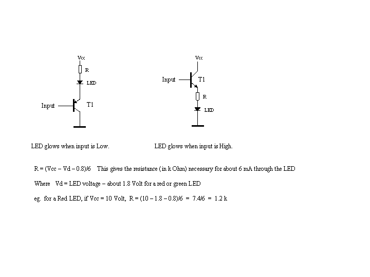

If you use an emitter follower, you only need one resistor.
And this arrangement reduces the load on the PIC i/o compared to a common emitter circuit.
See attachment.
But it's less efficient, and less useful, than the other way, which is why it's rarely seen - and usually it's a sign of poor design.
In what way?.
Why is it less efficient? I know that Ve is about 0.7V less that Vcc, but there is still enough voltage for the LED unless it is one that needs 3V or more. But the normal LEDs only need about 1.8V.
It reduces the load since the common emitter config needs Ib to be large enough to cope with the minimum beta in order to ensure saturation. In fact, the rule of thumb is that Ib should be one tenth Ic.
Whereas, in the emitter follower case, Ib = Ic/beta.
eg. if Ic = 10 mA and Beta = 200, Ib = 50 uA.
Otherwise, using the rule of thumb. Ib = 1 mA.

Surely, all the current flows through the LED and therefore this must be the most efficient circuit?
My LED needs 3.6V.
Peter
Because of the greatly increased voltage drop across the transistor, admittedly the base current will also flow in the load - but that's likely to only be tiny percentage of the load current, particularly in the case of driving a 40mA LED.

In that case, you need either an NPN transistor or an N channel MOSFET.
What current do you need through the LED?
For example, if it requires 10 mA then the base current needs to be about 1 mA. So the base resistor should be (5 - 0.7)/10 = 430 Ohm.
If you use a MOSFET such as the 2N7000, the gate resistor is not critical.
Use 100 Ohm.
