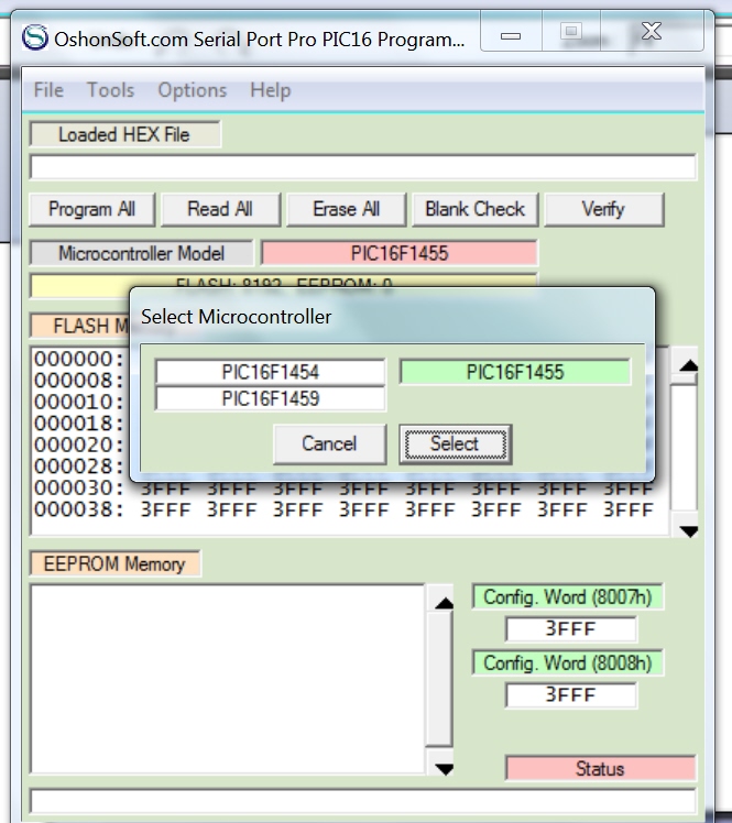

I want to programme a PIC 16F684. I have used ICPROG for many years for programming PICs.
However, ICPROG only supports a limited range of PICs & the 16F684 is not included.
I downloaded the trial version of the Oshonsoft PIC Simultor IDE but I cannot find a programmer in it. But I may have missed it.
Can someone suggest a suitable programmer please.

Yes, I need serial.
I'll download that software. It should work for any hardware as all the hardware does is to do buffering & level translation of the signals coming from the PC. The 16F PICs all need the Vpp, serial data & serial clock signals my hardware does this.
I have opened the software, but there is only a choice of 2 PICs in the “Select Microcontroller” pane – see below.
Does anyone know how to load more? I’ve searched hear & there and the Help but can’t find anything.
Possibly because its the demo.... Or have you the wrong one... There are three... Pic.... Pic16 and Pic18... You will need the first one... PicSimulator was for the low/mid range pics.... Pic16 is for the extended..
Thanks Ian & Eric for the assistance.
Yes, I was using the wrong one. I thought PICprog16 was the one I needed, but what I needed was the PIC Simulator IDE.
