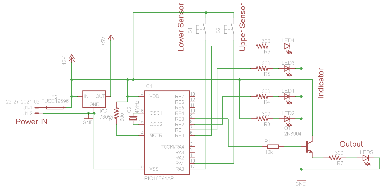

I've got a question in regards to programming a pic. What do I have to do to setup the ports as Input and Output and read the inputs to activate and deactivate the output. Currently if I try to use TRISA and TRISB in my code, the programing program throws me out with and error message.

I'm using multisim to simulate my circuit as it stands, and it only has PIC16F84 and PIC16F84A MCU modules. I had to clean up the code that you put on here, and I've got it down to one error, and that's symbol not previously defined (RP0)
Edit:
I fixed the errors and put a copy of the circuit that I have been working on. The LEDs represent the different connectors that will be on my primary circuit when I build it.
I declared the RPO variable and it cleared that error message. most of the errors were that the lines were in column 1 and I just bumped them over 5 spaces, and that got rid of those errors. it still doesn't do anything right now, that's frustrating to the max I've posted a logic description of how it should work in another thread here that shows how it should work.

I've been playing with the circuit in Multisim, and it still just sits there even if i do hit the switches representing the two sensors. I've temporarily put LEDs in the place to the connector to my secondary circuit which contains the indicator LEDs. The Flashing of the Warn LED will be handled on my indicator circuit with a 555. I've pretty much finalized the look of the indicator circuit, so I don't need help there, because it operates as I desire.
Use the command i put in my previous post since RP0 is not working. It is very important as it chooses the tristate register. It's very unclear what is not working...post your full code please.

I've simplified the circuit to use only the RB0 Pin on the MCU for the output and RA0as the input.
I see three things that might be wrong
#1 you are missing this line of code (it should be the third line)
__CONFIG _CP_OFF & _WDT_ON & _PWRTE_ON & _RC_OSC
#2 255 = 0xFF not 0x1F
#3 bsf and bcf should not be indented
#4 get right of RPO and just put a 5
#5 you should not need to define all the ports and tris registers if you are using MPLAB
#6
PORTB,1 ;set port b,0 = low
are you checking pin 1 or 0?
Try some of this out,
Mike
I'm using Multisim to simulate my circuit and MPLab to build the HEX file
No, not really. I'm getting a little frustrated :mad:
oh, it compiles, but it doesn't do anything when I try to use it in Multisim, it just sits there doing nothing.

I don't have the stuff to build the circuit yet, I'm trying to simulate the circuit and get it working before I build it.
Try running it through MPLAB or Oshonsofts simulator.
PS the transistor won't do much, use it as a current sink instead.
Also no need to redefine your SFRs as you're using an include file.
Thought you were going to switch to Swordfish BASIC for this HHO project?
I have designed another secondary board to control the final stage of the circuit. I'm using 12V Relays to switch the system around from run to refill and back. I need the 12V coming through the transistor to activate the relay in order to switch from run to refill.
ok, my system is a relay driving a relay. The first relay switches from run to refill, and the second relay turns on the refill system which consists of a refill control valve and pump.
Edit:
How do you emulate the high/low of the inputs to activate the outputs in MPlab? I have MPlab and Multisim and have been working on the circuit using Multisim.
