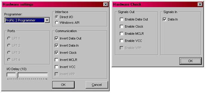

hi nigel ,
i tried to built the p16pro programmer and was using ic-prog to programme pic16f84 .can u please tell me in ic-prog->settings->hardware which programmer should i select. i tried selecting picpro but it did not work and also in icprog->view->device position the 16f84 is placed on the top side of ZIF CONNECTOR ,which is opposite of what is described in the programmer circuit.
thankyou

In IC-Prog you select "ProPic 2".
I would suggest you place the PIC where the hardware says to, the software is only imagining you have identical hardware to that it was written for.
hi nigel,
thanks once again for repying. but i did the same thing as you told and when i choose to program the chip, only one red led blinks with green one, and at the end, the message comes, "VERIFICATION FAILED !"......please help me sir.
Thanku
I can only suggest you try using WinPicProg, just so you can perform hardware checks. WinPicProg has a Hardware menu option, this allows you to manually set the IN and OUT pins, plus manually toggling them. By using these buttons you can very easily perform static voltage checks with a meter. By doing this you can confirm your hardware is wired correctly, and that you've got the chip in the correct place.

Amit garg,
Here is the hardware setting for P16PRO40 with 74LS06 in IC-Prog...
IC-Prog does support testing hardware...
If you wired your P16PRO40 programming sockets exactly as in the P16PRO40 schematic, you cannot use the ProPic 2 socket patterns shown in IC-Prog "Device Position"...
Good luck... Regards, Mike
