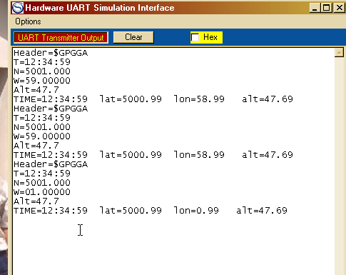

Hi E,
Do you have a live GPS to inject the NMEA?
I get the same result as you with simulation and injecting NMEA using a Terminal, but not with a live GPS.
I tried logging the live GPS NMEA and ran it as a Terminal Macro, which also worked and showed updating time.
So it appears to be some difference between how the GPS and the Terminal transmits DATA.
C.

Hi E,
I'll look at them the best I can with an Oscilloscope to see if i can spot any differences.
Using the Terminal, try this text. This works ok, with the minimum of information.
C.
  • NMEA GGA.txt

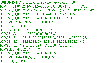

Hi C,
I have finally found a NEO I bought about a year ago.
I have it outputting all the messages, do you have a block of code that I can use to select only the GPGGA string.
E

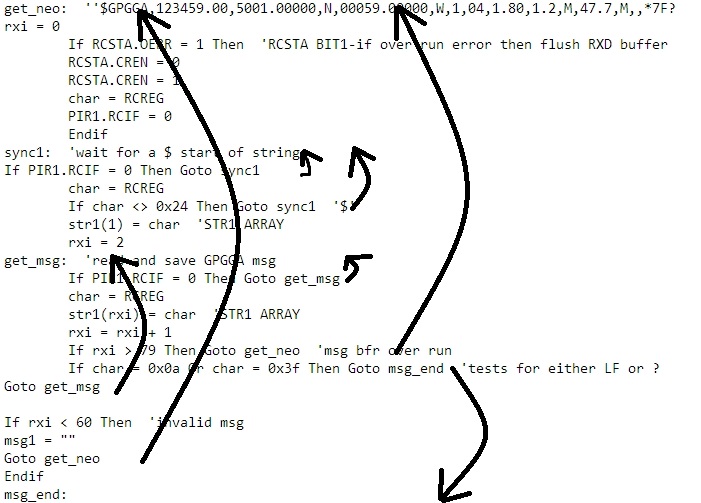

This is one problem.
The Serial out looks OK.
Goto get_msg
If rxi < 60 Then 'invalid msg
msg1 = "" '''''''''''''''''''''''''''''''''''' ' the msg must be cleared if too short.
Goto get_neo
Endif
E

hi C,
The NEO was still in its original wrapper, in a 'safe' place...:banghead:
The neo3V.bas is able to accept all the data msg strings from the NEO without any problems and extract $GPGGA msg.
Give it a go and let me know if you want any changes.
E

Looking at #266. How does the program get to 'If rxi < 60' ? To me it looks as though the it would jump over it. [I'll look again tomorrow]
Here's the HEX I compiled: Both program the same result.
C.
  • cam_neoV3.hex
Hi E,
C.
hi C,
If rxi < 60' ? ,' action
If length less than 60 then
'its a corrupt msg so
sdstr="" ' clear the corrupt msg from the buffer
then got back to the start of NEO and restart looking for the '$'
goto get_neo

I noticed that 'time' was updating on the 5110 when the lines on the terminal showed they were about 40 long, and when I looked at line 'If rxi < 60' the program appears to jump over it.
