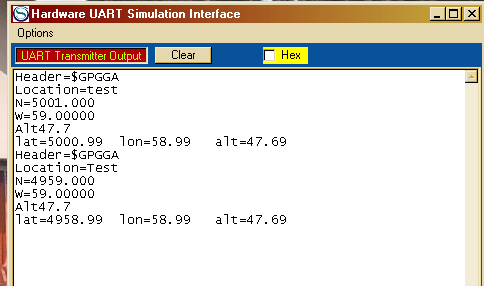

This is a demo Sim version of the program.
It takes an incoming GPS message and saves into an Array.
The array is then parsed into the main values as Named Strings also converted to Named Single Numeric values for Maths operations.
So to display a message on the 5110:-
call wr_msg( x0,y0, name of the string) '
eg: call wr_msg( 0,0, strlat) ' or if you prefer
msg1 =strlat
call wr_msg( 0,0, msg1)
The delay has been finding code that will work in Oshonsoft using String and Single combinations.

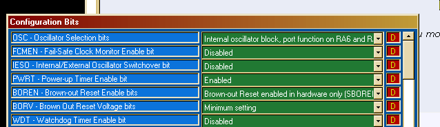

Using the Internal Osc at 8MHz with the PLL enabled would give 32MHz operation for zero cost and reduce the PCB tracks.
Use the Oshonsoft Config and select INTOSC as shown in this image.
OSCCON = %01110010 'internal 8Mhz clock
OSCTUNE.PLLEN = 1 '*4 PLL enabled so Fosc == 32MHZ
E.

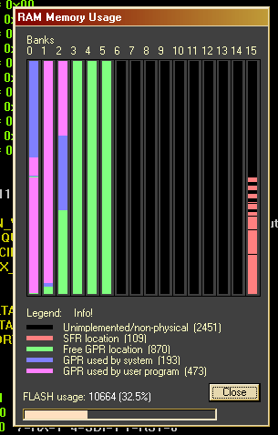

BTW I see that you are getting very close to using all your GPR space.!!!
This Basic cammy3.bas is a cleaned up version, note the GPR usage.

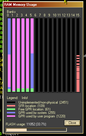

GPR are the PICs General Purpose Ram locations.
When you DIM a parameter as a String, the Program allocates that String as Bytes in GPR's, so they are not available for use by the rest of the Program.
The 18F4520 has only 1536 Bytes of GPR space,
In your original Program you have only 61 Bytes left.!
If the next section of Code you write within that Program uses more than 61 Bytes for DIM's etc... the Program will not compile.

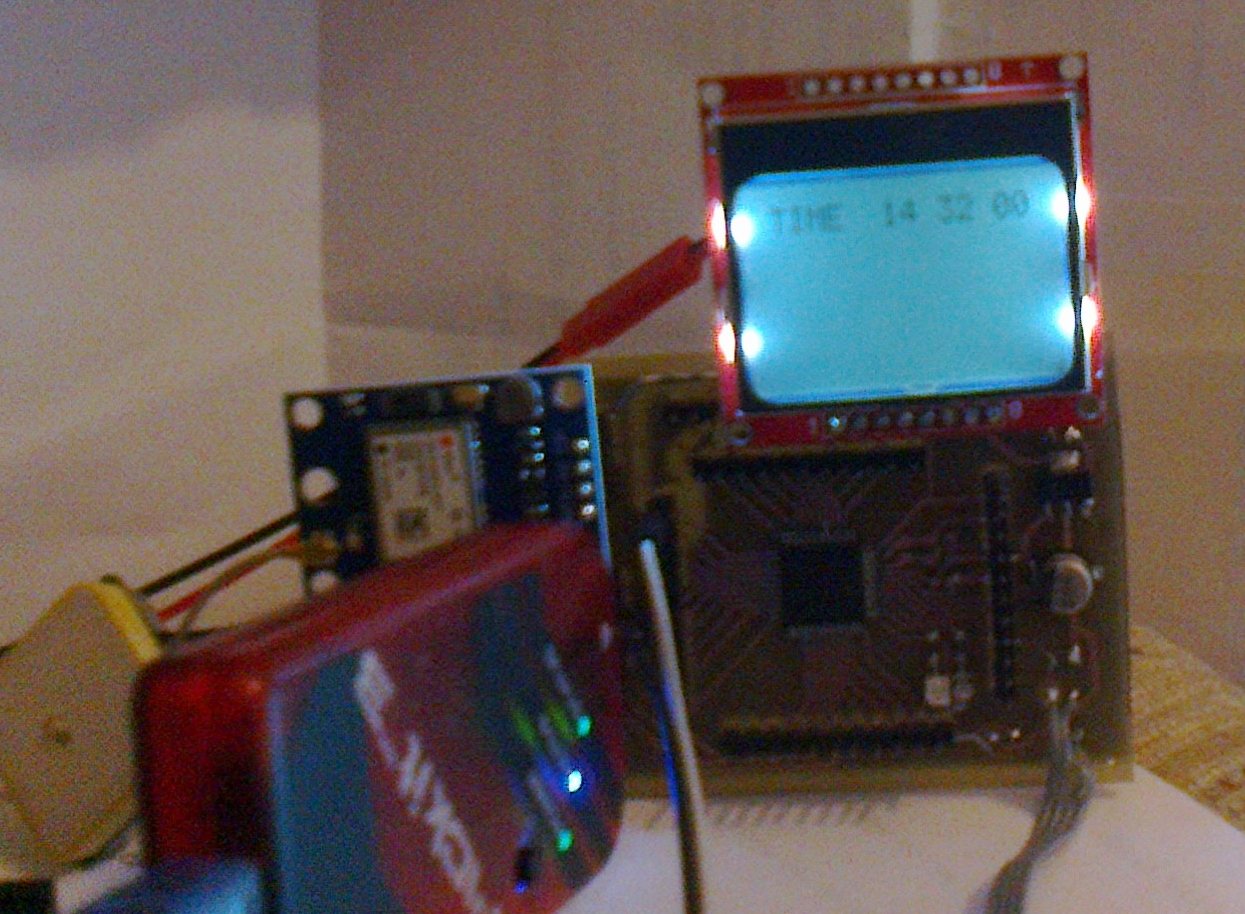

HI,
Success.
Here is a photo (Qualiteee) of the 5110 showing TIME and the time updationg ok. [No seconds!]
Here is the program:
I changed the GPS to an NEO-6 This isn't as sensitive as the 8, and I found that because it is in poor conditions, the NMEA sentences aren't being gleaned reliably, so I found one that always seems to show the TIME, so the 'verify' letter is 'C instead of G.
C.
