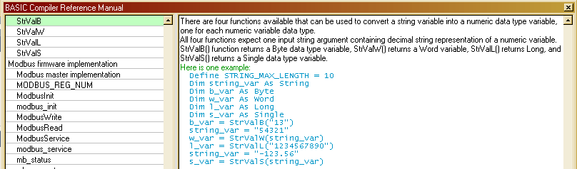

Hi E,
In your examples there is: 'Define STRING_MAX_LENGTH = 10' as we already have one for '60', I presume I don't need the '10' one.
BTW:
I don't think this PCB will be used to 'do maths' for LAT/LONG values, although I'll find out as it develops.
C.
hi C,
The String_len depends upon how you are capturing and saving the GPS string message.
If you wanted to save all the string as ASCII, you would set the string_len = 80.
If you are saving the GPS string into an Array buffer, you would use:-
Dim strxd(80) As Byte 'neo rxd data buffer
String_len =11' that's the Len of a GPS value ie: 00059.00000
It's advisable to keep the String Len as short as possible, as it uses the PIC's GPR registers, you don't want to run out of RAM space.
