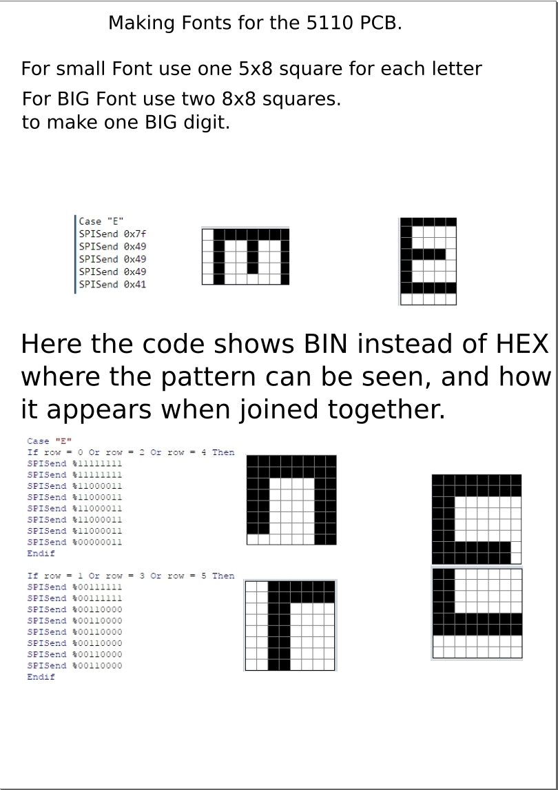

Here is the FONT1 with the missing BIG letters added.
C
  • font1.txt
