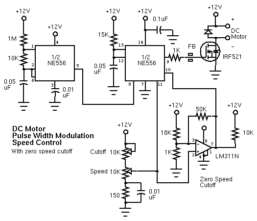

pic or digitl speed controller for a electronic golf trolley
russdana
I am looking in to building a electric golf trolley as a project, i was told that using a pic controlled circuit would be better but not essential, has anyone got any ideas i have looked around for different circuits but i have had no success.
The only criteria is that it has a output of 12V for the motor.
