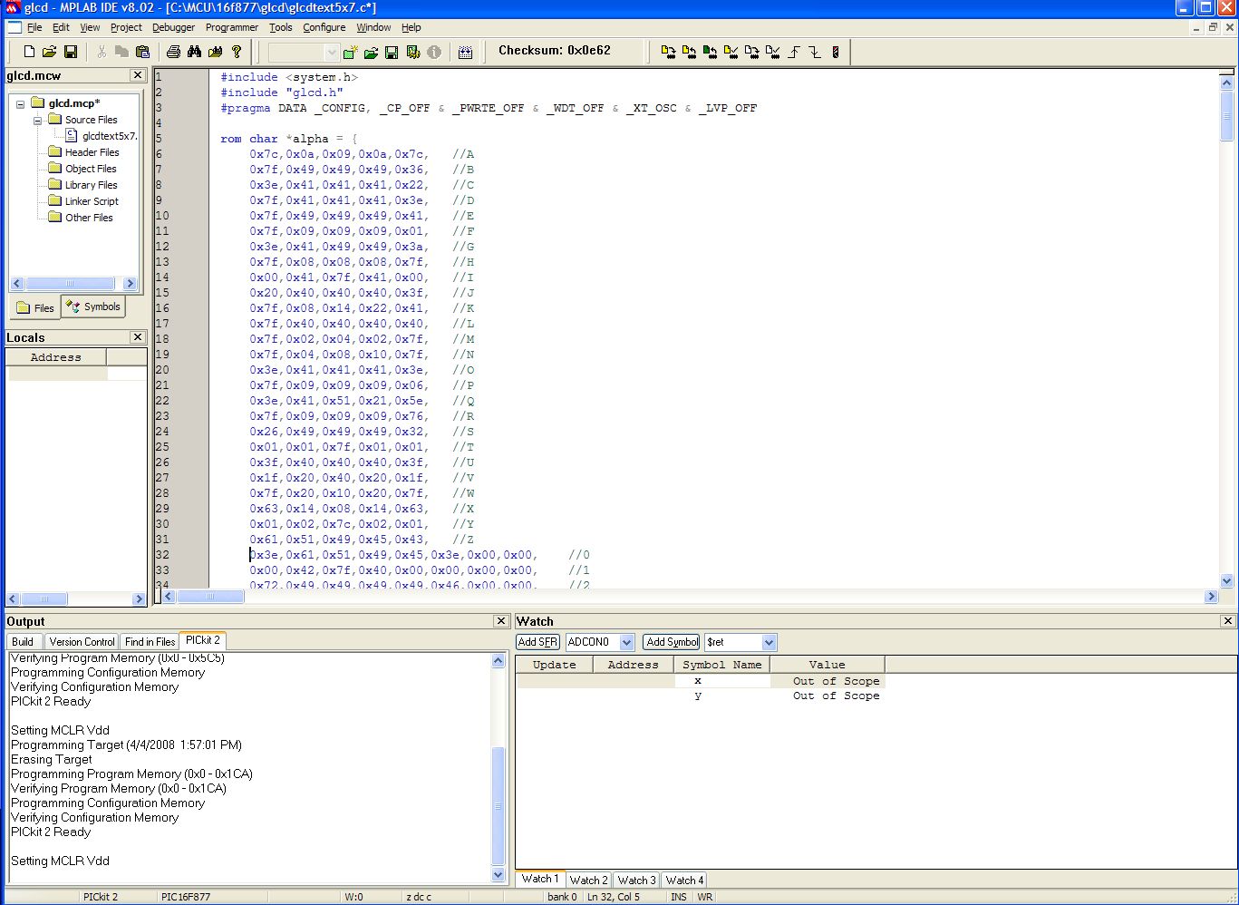

You can make MPLAB look very similar (maybe almost identical). The trick is to make your windows dockable. I run mine like this:
Sometimes I'll move parts to other positions, but that's the usual layout.
To make a window dockable, left click in the upper left corner and select Dockable. Then if you drag it to any edge it snaps (docks) to it. You have to dock things in certain orders to get them how you want.
Figuring out how to dock them takes a little practice. At first you'll be baffled by its behaviour. Play with it till it makes sense. :D

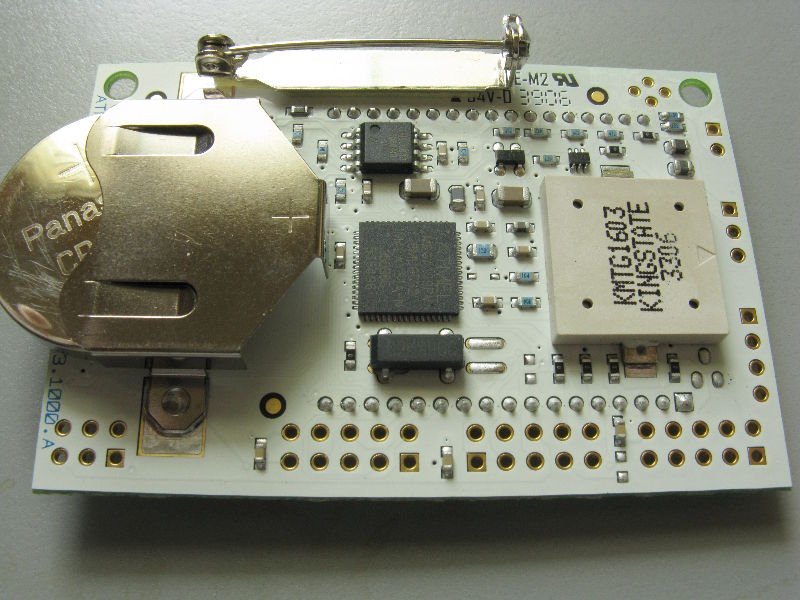

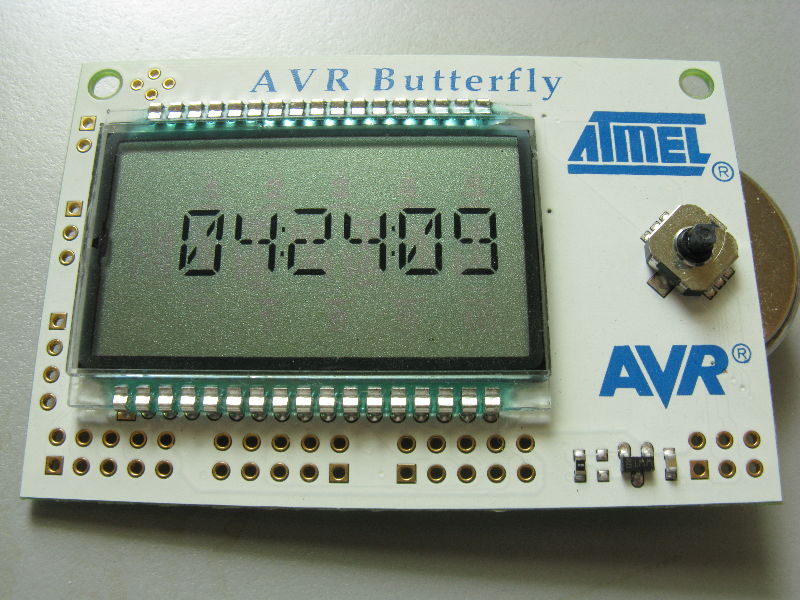

Hey AtomSoft! If you're ordering a Dragon and some AVRs, consider ordering yourself an AVR Butterfly demo board as a very cool geek toy as well. Only about $23 for a board with a Mega169PV, an LCD, a joystick, a temperature sensor, piezo beeper and other stuff.
Here's mine:
As you can see, I haven't done a thing with it yet. Still stone stock. One of these days I'm gonna solder in some headers and get programming on that thing. :p (The battery isn't supposed to hang out the side like that. I was having problems with the contacts.)
