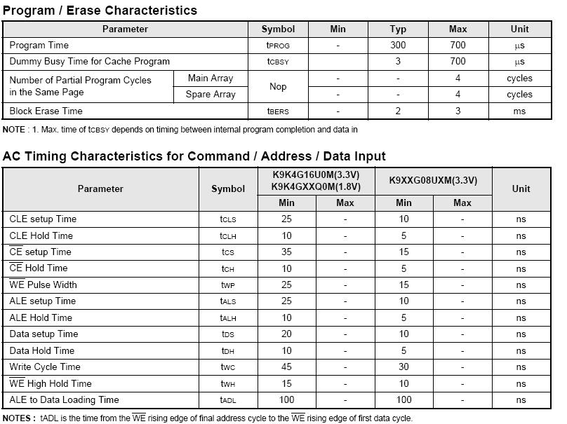

I have a question, how can I send ,via PIC's output ports, hundreds of ns (nano seconds) timing frames (Attached Thumbnails in one of my lasts posts) ?
should I use timers and prescalers to get this short cycles or is it possible by another way ?
how will be the procedure in C code ?
I don't see as you need any great accuracy for that timing, it's only giving minimum time requirements
It's not possible using timers, but if you're running at 20MHz a single NOP takes 200nS.
It won't, C is probably too slow and clumsy for such short timings - with C you probably wouldn't need any delays at all - the code itself would delay enough.

I don't see as you need any great accuracy for that timing, it's only giving minimum time requirements.
good notice , there is no maximum impulse duration in the table below (there is only 700us fixed as maximum programming time- see first row).
can you explain me more this detail ?
The nS delays are all less than a single assembler NOP, any C instructions are going to be longer than that - so there's no problem about exceeding the minimum times.
humm, the Assembler is so convenient when we want to optimize.
but it's not my case (there is no maximum time to excced-as shown in the table), and the PIC i'm using (18F4525) is made for C codes .
