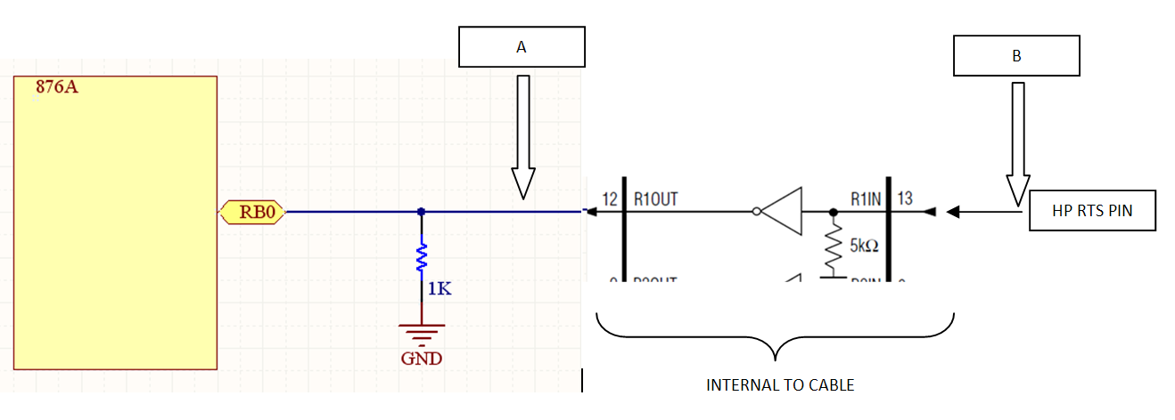

I am actually using my PIC to communicate with a Handphone. Everything's working okay and I'm adding a handshaking mechanism now. Attached is the connection diagram between the RTS pin of the handphone all the way to the PIC pin RB0.
I programmed RB0 to detect whenever the input goes LOW (modem gets disconnected) , that the RB0 interrupt would trigger , go to an ISR and at the ISR wait for RB0 to go high again before going back to the main program. At the point of disconnection in the ISR, an indicator ERROR LED lights up and goes off when RB0 goes high again.
The program works fine when I disconnect at point A, RB0 gets pulled down to GND and a good Logic 0 is detected. However, when I disconnect at point B (dislodging the phone from the cable head), the program does not work at all. I know for a fact that the RTS pin goes through the MAX3232 (internal to the cable) before going to RB0. If the RS232 input is left open (phone gets dislodged) , I probed the voltage and got approximately -1V.
Any ideas on how I can properly interface so that although I disconnect at point B, a good Logic '0' goes into RB0?
im attaching my ISR code just in case it's a software bug
IntServ:
		btfss	INTCON,INTF
		goto	notRB0
		bcf		PORTB,1			;off CONNECTED LED
		movwf	old_w
		swapf	STATUS,w
		movwf	old_status
waitconnectback:
		btfsc	PORTB,0                            ;wait for modem to connect again,else
		goto	connected_again                ;on ERROR LED
		bsf		PORTB,2
		goto	waitconnectback
connected_again:
		bsf		PORTB,1			;on CONNECTED LED again
		bcf		PORTB,2			;ERROR LED cleared
exitISR:
		swapf	old_status,w
		movfw	STATUS
		swapf	old_w,f
		swapf	old_w,w
notRB0:
		bcf		INTCON,INTF
		retfie
