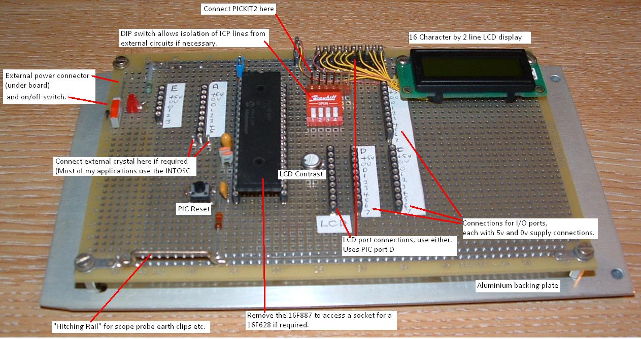

Here is mine:
The thing is wired up "rats nest" style on the underside of the board.
The backplate is connected to the 0v supply lines to provide the basis of a ground plane.
mine is quite tedious to build........

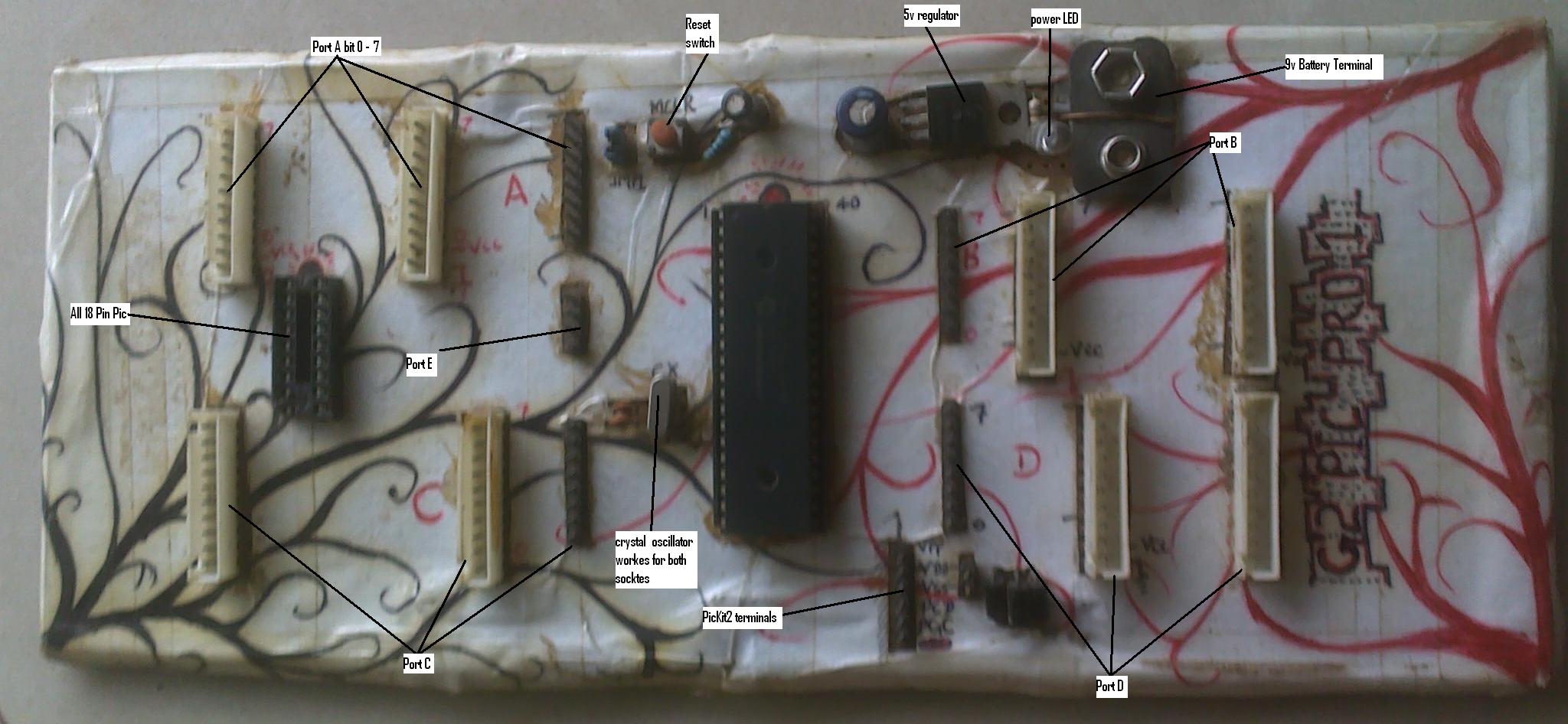

behind the board is covered with plastic glass which prevent the connections from been altered. Ive used it for 2years and it still works fine
