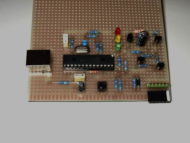

A very simple diy pickit2 lite is really quiet easy to build, either with a pcb or hand wired.
Heres one I did earlier... though it will still cost you about £10 - £12 in parts so a bought one might be your better option for now.
Either way am sure you will be more than pleased with it - don't forget it also includes extra tools that run on the pk2, like the Usart tool, Logic Analyser , Programmer -to - Go etc.
