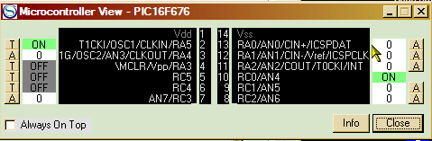

Your program will not assemble in Oshonsoft.
Modified the code so that OSH can run it, the ports are not being initialised correctly , look at this image.
PORTC.1 is set as analog.???
I have used only RC0 bit as output. All other bits are input. Would it make any difference if PORTC,1 is set as analogue ? Actually the literal b'00000001' is XORed with PORTC and after XORing, the result is stored in PORTC. Hence the command:
xorwf PORTC,1
Looking for assistance from any member please.
Yes it would!

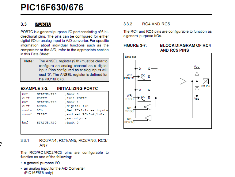

You must set PORTC as a digital output if you want to drive an LED.
Look at this code fragment on this image.
