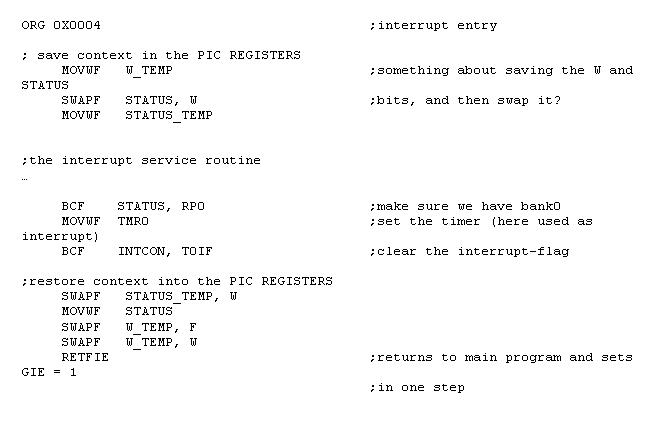

I found this bit of code and made my own comments (please correct me if I'm wrong).
I also find this C code, maybe that's easier for you to explain me where the program goes to with interrupt

The assembly language code is a good illustration, but I have one question. What value is being written to TMR0 by the 'movwf TMR0' instruction. Should there be and instruction that loads the W register with a meaningful value before you write it to TMR0?
It is not possible to verify by inspection of the C code what the compiler is doing. That is part of the problem. Just because you create a function called "interrupt()" does not mean that the compiler will do the right thing. I suppose it is barely possible that this is the way your compiler works, but you must dig deeply into the compiler documentation and find the non-standard syntax which tells the compiler that it is dealing with an interrupt function. Then you must look at the compiler output with the assembly language statements and the c code interleaved to see that it did the right thing.
In assembly language it is easy. Any code that executes after the Program Counter is set to 0x0004 is by definition an interrupt routine.
In the 16F877A datasheet(DS39582B,(c)2003) please refer to page 153, figure 14-10 for a diagram of the OR gate that continuously monitors all the flags(file register bits) which can cause an interrupt. I don't know if this will help you but, an interrupt is like forcing a special "call 0x0004" in between two instructions. The call is not really there in the instruction stream but the processor acts as if it was. What is special about this call instruction is that further interrupts are disabled. When the RETFIE returns from the special call everything should be the same as it was before the call. W has the same value and the STATUS bits are the same as they were. Some RAM locations and other file register may have changed, but that should have no effect on the code that was executing befor the interrupt happened. It should be an OBVIOUS programming principle that you cannot change file registers in both an interrupt routine and the main code. You can READ and TEST things in both places but you cannot WRITE them in both places. If you need to work with multibyte quantities in both places you need to disable interrupts while you manipulate things in the main code, then reenable them when you are done. If you think about this for a minute the reason will be obvious.

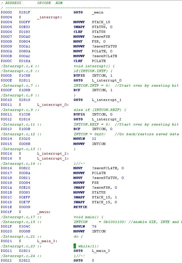

It's all getting much clearer so I wrote this code in C and then compiled it to assembler. If you find something suspicious please post it
... and yes there should be loaded a value into the TMR0IF bit.
I figured out, that mikroC know the function interrupt within all its declarations like INTCON.RBIF and OPTION_REG.PSA. Hope you can figure out the messy code format.

Bravo Sir!
You did it all with just a little bitty push. It would seem that your compiler considers that any function named "interrupt" is going to be linked at location 0x0004. Not only that but it produces a very nice interlist with the assembly code and the c code interleaved.
Good Luck on the rest of your project.
