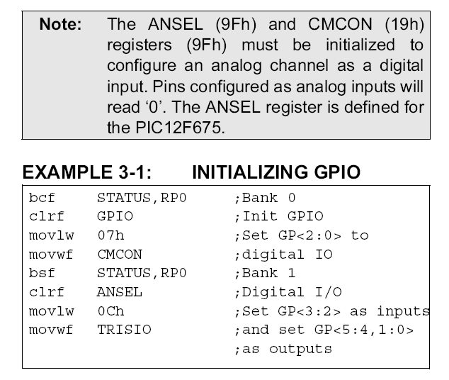

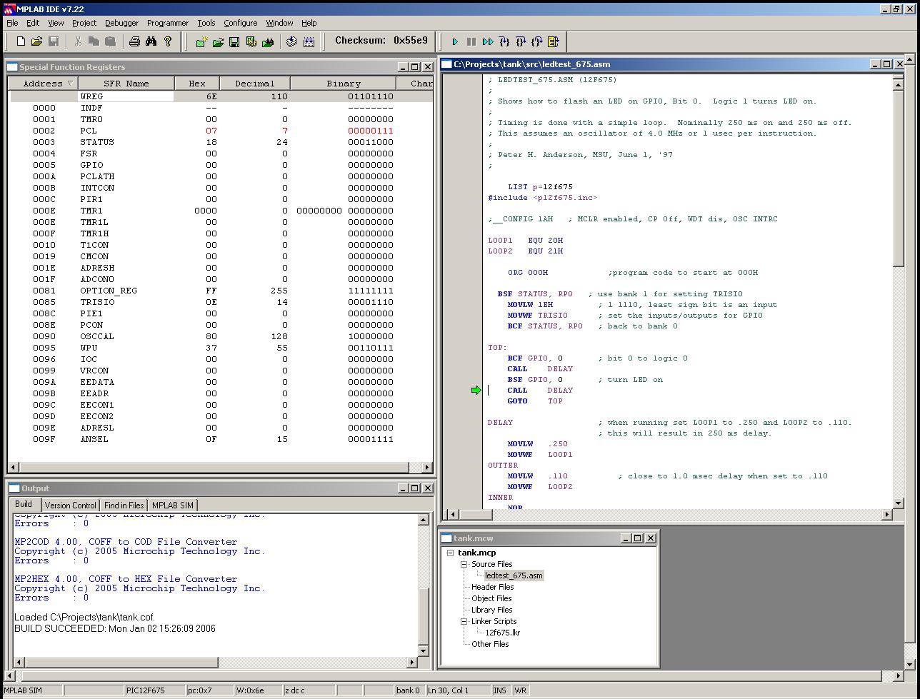

Hello, I'm getting into PIC programming for robot projects and I'm stumbling a bit on a seemingly simple first test. I'm working on porting a project code from a 12C508 over to a 12F675, and even a led flash is giving me trouble.
I've run my code through a simulator, checked the datasheets, and it seems that I should be getting the my ouput pin to a logic 1 on the GPIO but even in the simulator it's not doing it. I've tried a number of different combinations, but the GPIO in the simulator never changes. It should be set to bank 0, from what I can tell.
I'm sure it's some silly thing I've overlooked, so I just wanted to ask for help on this.
Thanks in advance for any advice,
-sirlacksalot
