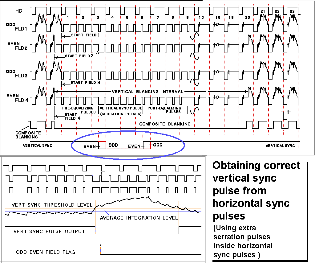

If you goes the interlace path, then your code will be more complex. I'll show you a picture. Notice the area circled blue, for interlace mode, the even field VSync needs to be outputted at the time in between the middle the two successive HSync pulses.

You don't need equalising pulses if you generate the VSync by code separately. Real life TV signal need them because the VSync can't be sent separately but have to be embedded as part of the transmitted video signal.

I see that interlacing for now isn't an option, but why are on that picture 4 fields, a picture is divided in two fields, odd and even?
If you looked closely, you will see there is a sine wave between HSync_Pulse 9th and 10th. This denotes the phase of the color burst but it would not concern you as you are not using color. Field 3 and 4 is just the repeat of field 1 and 2, only difference is the phase of the color burst changes.
Also from where is that picture maybe I can get some info there.
Unfortunately, that image has been taken from the 2005 archive of my harddrive and I cannot locate where it originates from. Sorry for that.
