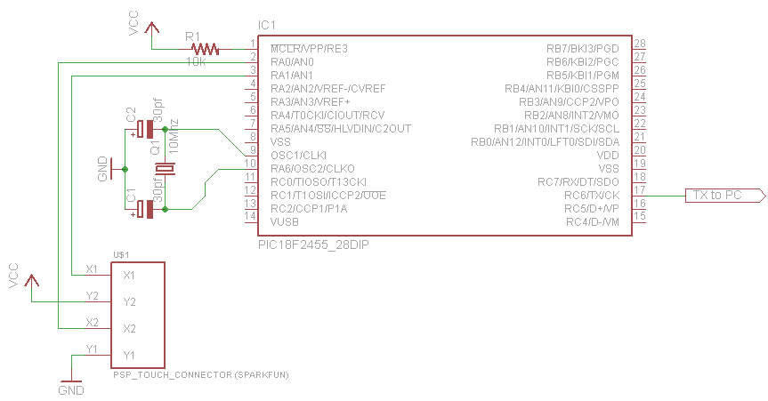

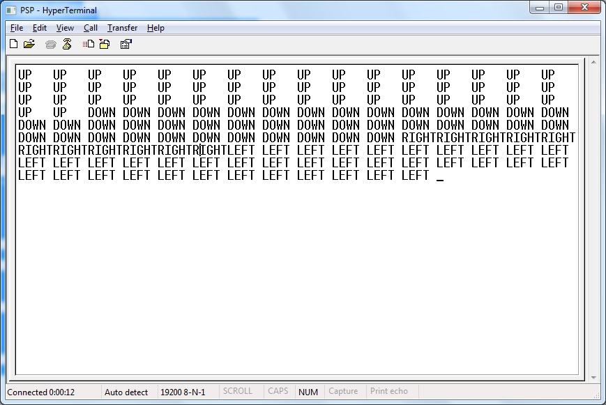

Hey guys i have people ask me now and then how to get data from PSP JoyStick... Where here is some pic code i made. I will draw a schematic in 10 minutes and also a small video and pictures of exact pinout... I hope you will appreciate and enjoy this info... At the end ill create a PDF with code and images for easy portability...
Quick Rough Draft... I dont have a 18F2525 Part in Eagle... maybe ill update this tomorrow with new part... But heh its a start.. The PSP Part can be found in Sparkfun Eagle Library.

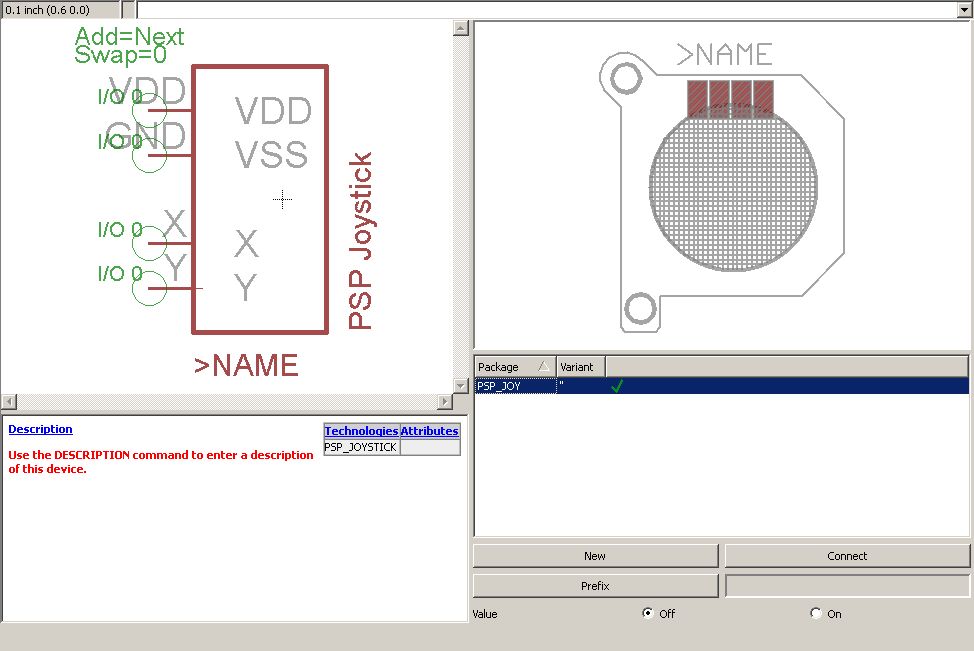

I'll post my Eagle part for this. I took a look at the SFE part and it just has the pads and a general outline of the part. I made mine before SFE put the part in its library. Mine actually has a well defined outline of where the part is going to sit, along with holes defined in the correct places for the two mounting holes on the package. The labels on the symbol aren't as nice, though. I didn't make this pretty, but I needed to have the proper package outline for placing it on a board and this might help someone.
Also, watch out if you want to reflow it or hot air it. The part I did this on still worked, but the movement of the stick was not smooth anymore. Also don't wash it, if you are washing your board. There's grease inside it.
Unfortunately, .lbr extension isn't an attachment option and I'm not going to ZIP it just for this, so here's a link.

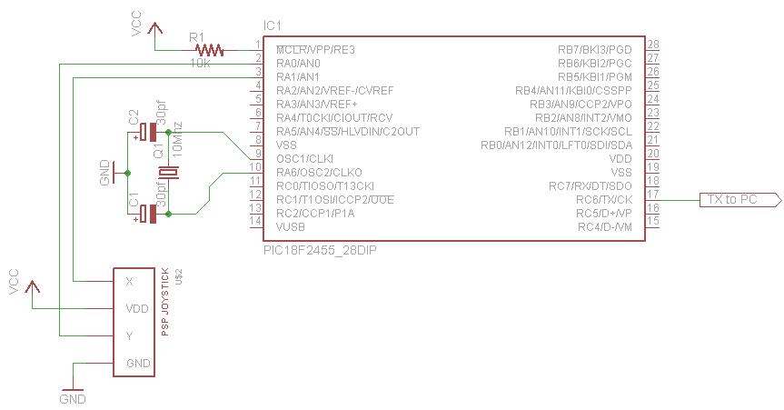

Thanks i just downloaded it and going to take a look. Im sure its way better heh... ill change the PDF and scematic with it... Thanks again!!! Do you mind if i host the part online for others to download?
Hey mark Dont be mad! but i edited the part. So it has the X,Y and GND,VDD.. heres a screen shot:
It's yours to do what you want with it. All I cared about was the proper outline and the correct placement on the mounting holes so everything else is pretty rough.

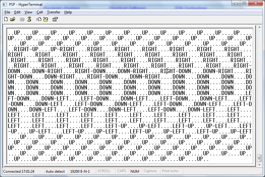

Here is a updated code which include corners... Like
UP, UP-RIGHT, RIGHT-UP
RIGHT,RIGHT-DOWN,DOWN-RIGHT
DOWN,DOWN-LEFT,LEFT-DOWN
LEFT,LEFT-UP,UP-LEFT
psp_hyper2-jpg.39277

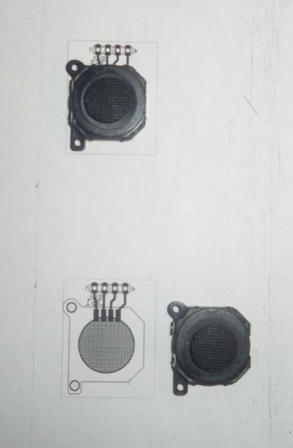

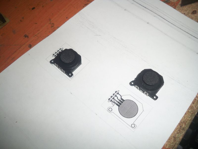

Here are the pictures i said i was going to post...
I dont use soldering iron for this part... i do a little trick... i presolder both pads then i preheat the board with heat gun and simply place part and heat for short time... but i will extend pads too.. seems more usefull
