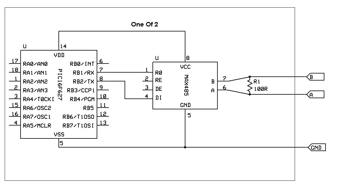

So would this be correct?
That's close. You need to tie RE and DE to a pin. They can both go to the same pin. /RE is a Receive Enable pin and DE is a Driver (output) Enable pin. Set /RE and DE low when you expect to receive data and set /RE and DE high when you want to transmit data.
And don't forget to actually connect power and ground to the pins, and your ICSP header too.
Is the code for RS485 the same as RS232. I am using flowcode, which has the RS232 component, but no RS485.
