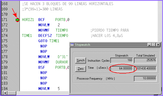

I built the same circuit recently, and discovered that the horizontal sync that it output was at 16Khz rather than 15.625KHz, making it a bit useless with most of the TV's I tried it with. I don't suppose you have any idea why, do you?

I didn't have any MC1377 encoders to hand, so I built it to output R,G,B and composite sync via a SCART socket instead. Each signal was buffered using a single NPN transistor and associated resistors.
Having tried it on a couple of different TVs, and had a blank screen on one and a horizontally rolling picture on the other, I decided to scope the sync signal. That's when I found it was 16KHz!
Maybe the MC1377 somehow copes with this and ouputs a perfect 15625Hz sync signal? I very much doubt it, but you never know :D

I had 'scoped the sync signal, and it didn't look like 64uS pulses to me, more like 62uS. My frequency meter said 16001Hz but as you said, it could well have been counting the vertical pulses as well!

You have got me interested and I loaded the source file in MPLAB to see how it performs.
By setting the breakpoint on the start of horizontal sync tip instruction, the results on the stopwatch indicates that exactly 64us has elapsed between each break. So this cannot be the reason for your present problem and the HSync pulses is indeed occurring every 64us.
