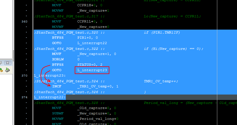

Problem 1: As I was checking TMR1 flag first.. if there was a capture, then TMR1 overflowed, it would first read the overflow, increment the counter, and clear the flag. Then check the CCP routine, reading in the capture, along with the extra (erroneous) timer overflow that occurred *after* the capture.... and than check the timer flag again (even though it was previously cleared).
Problem 2: Incrementing the timer overflow counter, shortly after it has been cleared, is indeed a no-no.
I have moved the TMRIF checking to after the CCP1. TMR1IF is only cleared in the checking code, not the CCP1 routine - but still checked in the CCP1 routine, and.. providing the CCP1 capture value is low (was captured just after the overflow) it increments the 3rd byte of the capture value (+OF x 65526).
I am still having issues, and I now have two example codes to work through (both assembly). It is proving tough to separate out the bits I don't need, whilst seeing whats happening.
I haev rewritten this at least 6 times so far, and in my latest test, I made minor mods to the code I posted, and instead of spitting out a 'P' when it the result is over 16-bits, I send out a copy of the latest capture value. I have left it running for 20 minutes so far, and have 12 overflows with a 200Hz input. All the values it kicks out are very low 0x0005, 0x0002, 0x0006 etc.. EDIT: Also seeing some very high values: 0xFFF4, 0xFFF2.
So... this says, the capture value when it flags up an overflow occurs just before the capture. As my prescaler is 2 (apologies, I said it was 8 earlier, but the calcuations afterwards take this into account), that means if the capture is say '5', that is 10us.

If you can find a way to view the assembler code created by the "C" compiler it might be worth looking at that in case the way it is compiled is causing the problem. (It took me a long time to find out how to do this with compiled "C" code on an Arduino.)
Les.
Les,
Yes, I generally have the generated assembly in view, and check what it does for various C comparison routines.
I'm glad you mentioned that because that leads me to .. a long post about detective work and bugs. Warning.. long post.. One of those bugs I think is a compiler bug (I know many blame the compiler for their own silly mistakes, but it really is...). Yesterday I stripped it all down and when the main routine detected an overflow (32-bit period output > 65535) I sent the 'new capture' and 'old capture' out the UART. After leaving it for an hour I picked up quite a few outputs and noticed a pattern:
    should be 135.7Hz = 3684 count = 0E64

As you can see, if we just look at the values as 16-bit, the differences are all very close to the ideal - 0E64. The variation is probably down to my simple 555 timer generator not being overly stable. If it was my frequency generator dropping pulses, then the results wouldn't all be roughly the same.
So, it only flags up an overflow when within range when :

I suspected that the extra bit of code used to check if the timer1 had overflowed during the CCP1 routine was always adding an overflow count if timer1 overflowed during - regardless of the value of the captures high byte.
The original code:
// check if timer1 overflowed whilst we are servicing this:
        if (PIR1.TMR1IF)
           if (Hi(New_capture) == 0);
              TMR1_OV_temp++;
Checking the assembly output, I found this:
Anyone who has done PIC assembly can see that, _New_capture+1 is moved to W, XOR'd with 0 so the zero flag is set if the W reg is 0. If set, it should replace the goto statement with NOP, and execute the INCF statement. It does. But... if the result isn't zero, the goto statement is executed.. and goes to.. L_interrupt23, which is also the INCF statement. So it always executes, regardless of the value of _New_capture+1. It should goto L_interrupt22.
So I replaced that routine with one that checks both the TMR1IF, and that Hi(New_capture) is 0, in the same line. Seems like it only does it if an 'IF' statement executes only another IF statement and nothing else. As soon as you add an extra line in there, the above bug disappears.
