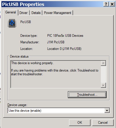

I am relatively new to the PIC world (having previously dealt only with the dsPIC30F/33F family) and I recently acquired a development board from Futurlec.com in order to do some PIC development [https://futurlec.com/PIC18F4550_Board.shtml]. Because the PIC18F4550 has a USB interface, this board is supposed to have the capability of programming the PIC directly, using only the USB connection between my PC and the board and as such this board is supposed to be 'ready to run' out of the box.
To my surprise, there was no programming software for this board on the CD and nothing else except a flimsy 'manual' (attached) and a few demo hex files. I managed to get the board recognized under Windows XP and have the Microchip USB drivers installed (see picture), however I failed so far in loading a hex file to the PIC (using WinPic800 and PICPgm). I am assuming the USB bootloader must have been loaded onto the PIC otherwise Windows wouldn't have recognized the board.

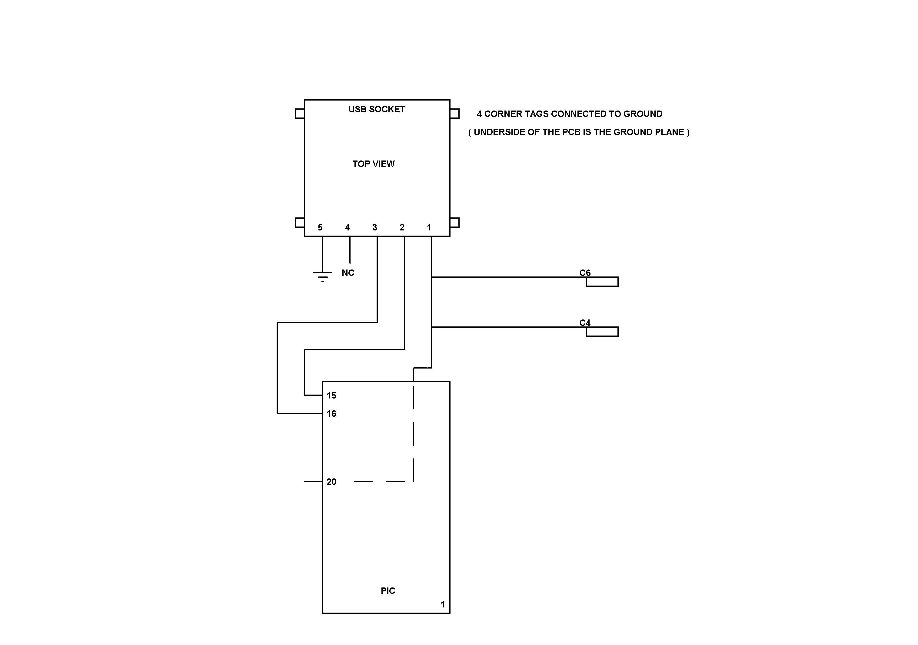

I finally received the damaged Pickit2 today and Richard you were right, the Usb connector has been ripped off the board resulting in two of the three traces being damaged.
I was expecting an easier fix but nevertheless I will attempt to fix this. The problem is that I have a very, very basic soldering iron that is not suited for SMD work or thin traces (tip is too big and not interchangeable).
Any suggestions are very welcome. Thank you!

Think you have two ways of repairing the board, reattaching the mini socket or connecting some wires , coming out of the pk2 to a standard usb socket.
For these wires or track repairs, suggest you use some 30 awg wire, such as the wire wrap type, - it solders easily.
Attached is a layout of the visible socket track on my pk2, which might help your repair.
Richard

Thank you again for your advice! :) Richard, your drawing helped when soldering things together, and Futz, I intend to do electronics for a while, but before I get heavily into it to justify $100+ equipment, I decided to start easy. I will come back to this topic later and look at a Weller soldering station in the future, should I decide I need one.
I went today to Circuit City and got a cheapo Nexxtech soldering iron kit. It was $20, but I managed to repair the Pickit2 together with my roommate.
Initially I wanted to repair the traces and just position the original USB connector back in its place. He suggested a less elegant approach, using wires that we connected from the pins of the connector directly to portions of the traces that were still left intact. We went with his idea as it was the fastest approach and I got the Pickit2 working.
