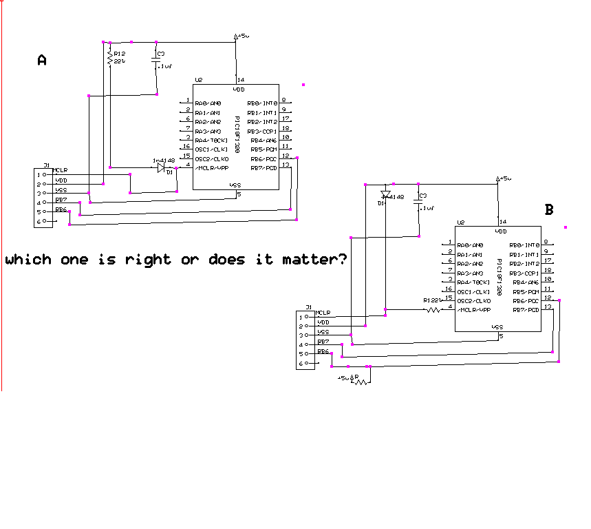

Ran across a different way to connect a PIC and wondering if it makes a difference?
Have only used circuit A
In question is circuit B.
or does it really matter?

When your Pickit2 tries to reset the chip by setting MCLR low the diode will effectively short out the supply. Actually, the diode will probably release the magic smoke.
