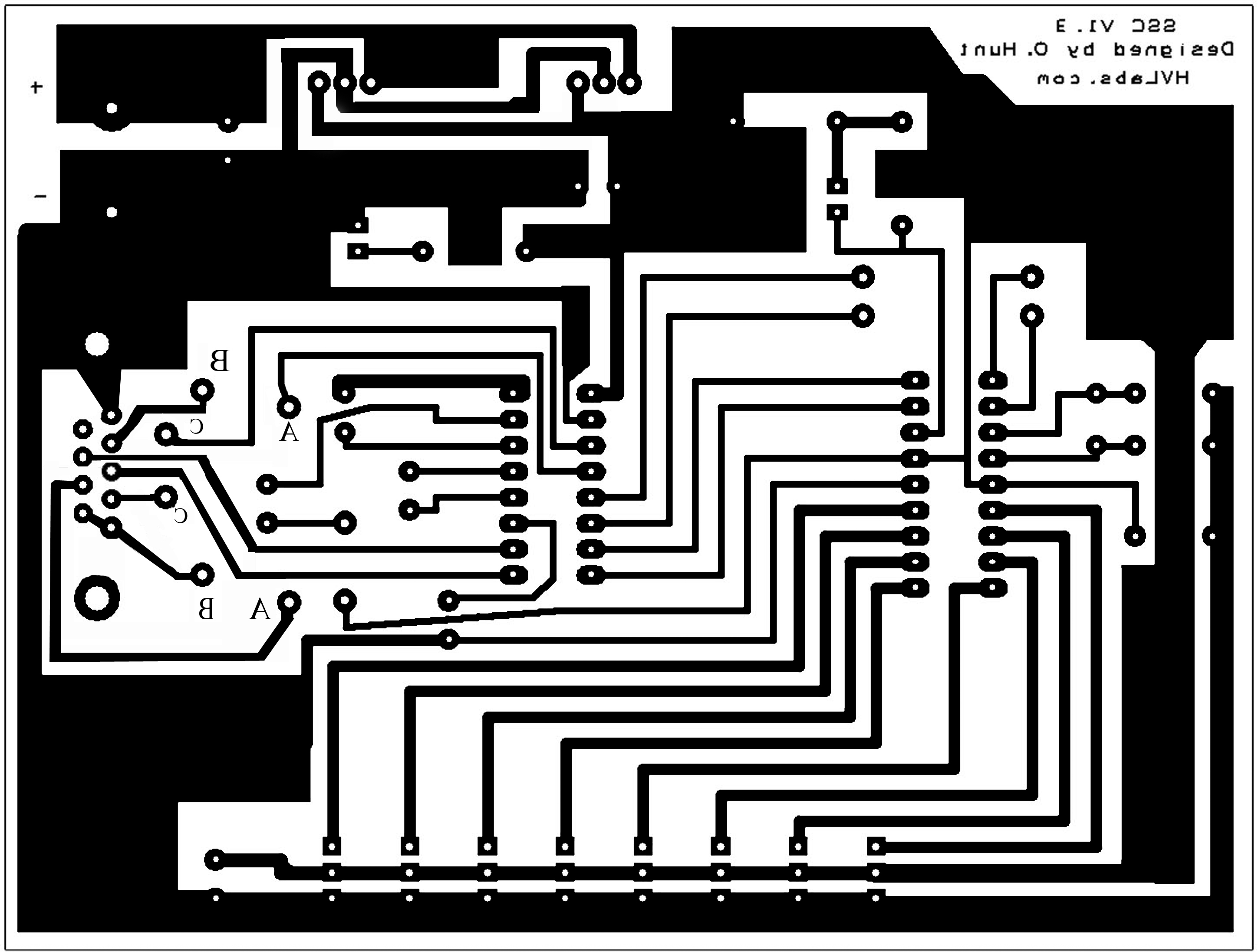

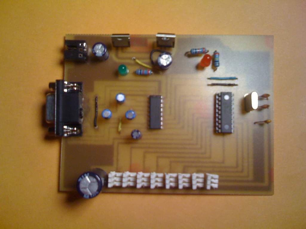

Thanks for the great servo controller. This was my first time etching a PCB, and I am pleased with how it turned out.
I didn't realize until after I already etched the PCB that the pinouts on my 7805 regulators have the ground in the middle, so I had to cut some tracks and add jumper wires.
Also, the image on your website has the pinouts mirrored for the D-sub connector, or at least what I can get in the USA: DRB-09SM - PCB DB9 Female Right Angle .380 Connector 50 Pack. It would work for puting the D-sub connector on the BOTTOM of the board, but not on the top. I cut all the tracks and wired directly to the Max232. (Did I do something wrong?)
I have a modified image (hope you don't mind) and I posted it below, that has the correct configuration for D-sub 9 PCB mount, along with the standard 7805 (common in the middle) pinouts.
with a 12 Volt 2.2 amp transformer, I am controlling 2-3 servos with no problems, and not much heat. I think I'll need more amps for much more than that, but the 7805's I got are only rated at 1 amp each, so I probably won't push it.

I separated the power, so that one voltage regulator feeds the PIC and MAX232 and another feeds only the servos, and this seems to have fixed all twictching and resetting of the PIC.
It appears that having two separate regulators works better than having them in parallel, and up to 4 servos can be run with only a 1.5 amp supply.

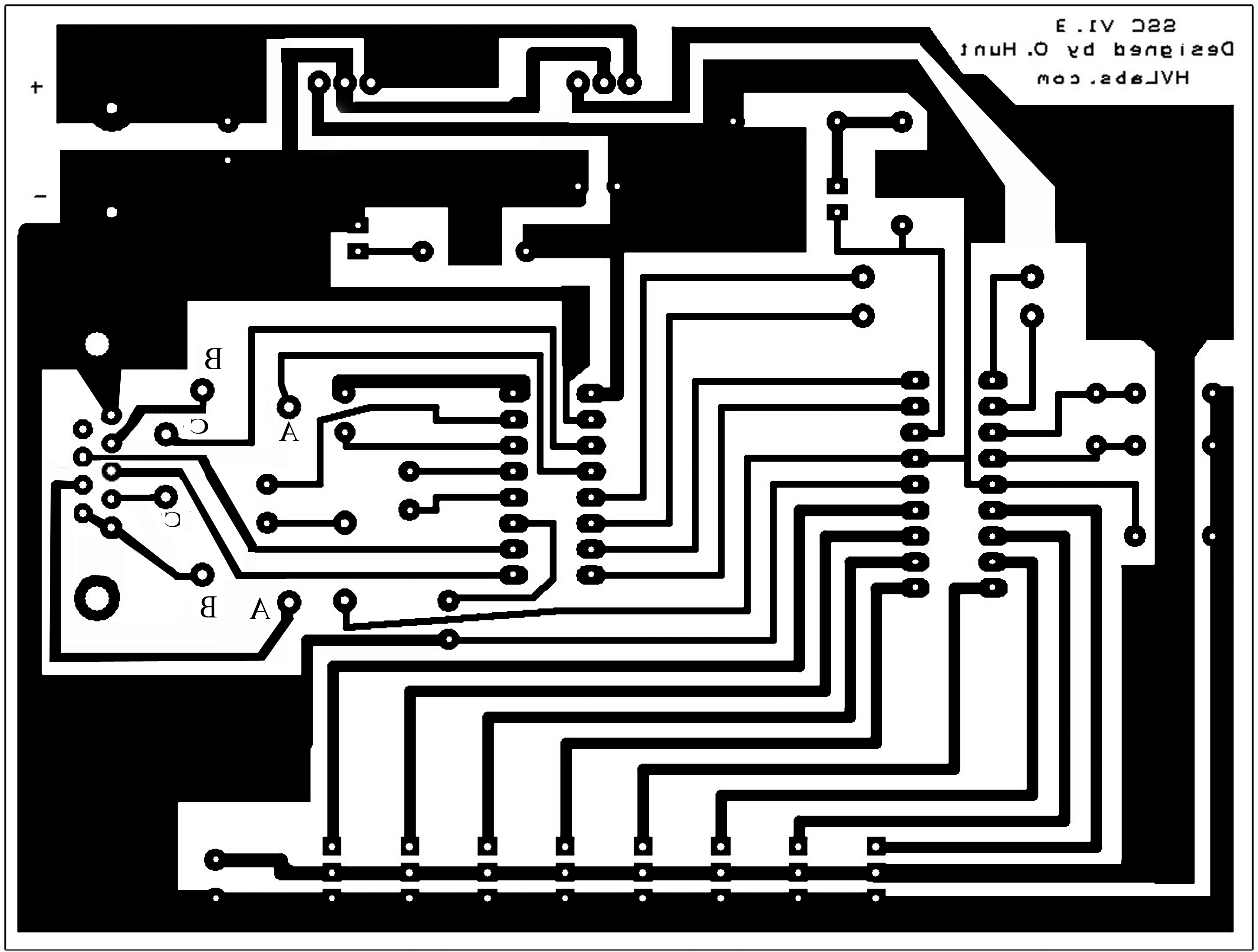

Olly hasn't been responding, and I hope he doesn't mind, but this is the PCB design I am using now with the modifications made to use standard pinouts for 7805's, the correct pinouts for the d-sub 9, and separates the voltage regulators so that one only feeds the servos. There are 3 extra jumper wires on it then the original, so at some point it will probably need to be completely redesigned in Eagle.
Working like a charm!

Hi. I hope someone out there is still reading this thread. I have built the SCC board but I just can't seem to get it to work. Can anyone please help me I have emailed Olly direct but get no reply. The board powers up and I have all the voltages correct with power LED on. I too had to do some jiggery pokery to get the board right. I can pulse with a logic pulser on the control lines of the servo and sure enough they move. Im pretty sure all of the electrics are ok. The ting im not sure about is the wiring for the RS232/ MAX232. Can anyone tell me which pins go where. At present I have :
RS232 MAX232
1 --------------------- Linked
2 --------- 14
3 --------- 13
4 --------------------- Linked
5 --------------------- Ground
6 --------------------- Linked
7 ---------- 8
8 ---------- 7
9 --------------------- Not Used
Is this correct? - The software runs very slowly which I think is because there is no communication to the board.
