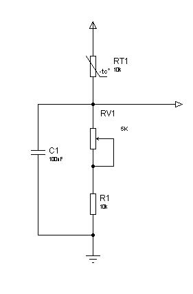

If you say a range of 0 to 50C then you will have resistance of 4161 to 27219. Picking a resistor in between these values of 15000 would give ADC readings of 660 to 222. Your biggest problem is the fact that the device is not linear and so you will need a lookup table for the other temperatures.

Edit, you may need to buffer the above circuit with an opamp but you may get away with a high quality 0.1nF ceramic capacitor to ground.

To answer your original question, the circuit below for the ntc is better as you will find a trimmer is needed to adjust the ntcs to your software.
You will find the ntc output a slight curve and your software needs something like a look-up table / algorithm to convert the adc value to a temperature reading.
Although called the poor mans temp sensor NTCs can easily measure to 0.1c accuracy.
