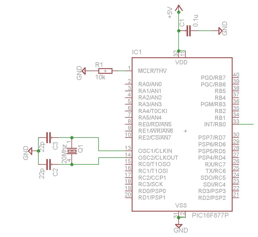

Hello everyone,
I am not a pro electrical and this might be a simple question.
Is placing 2 capacitor 0.1uf necessary between Vdd and ground?
Q1> If yes why?
Q2> If yes shall i place 1 or 2 capacitors?
See attachment to understand more.

we definitely Thank you as you are rehearsing our knowledge.
1. YES, the cap is necessary to bypass all the electrical HF activity created by the chip, thus preventing noise on the Vdd line.
2 One would do if you are shorting the lines across the chip as they are on either side of the chip. If independently fed, better have two caps.

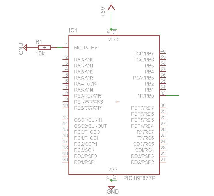

Thanks mvs,
This circuit will be used for driving a servo motor. Many of you already know this :) See attachement if interested in my diagram.
Prior driving a servo motor, I am interested in testing it using Oscilloscope. Therefore, I connected RB0 to oscilloscope to see 2ms on time and 18ms off time. My problem I don’t read anything from the oscilloscope anyone knows why?
The codes are here

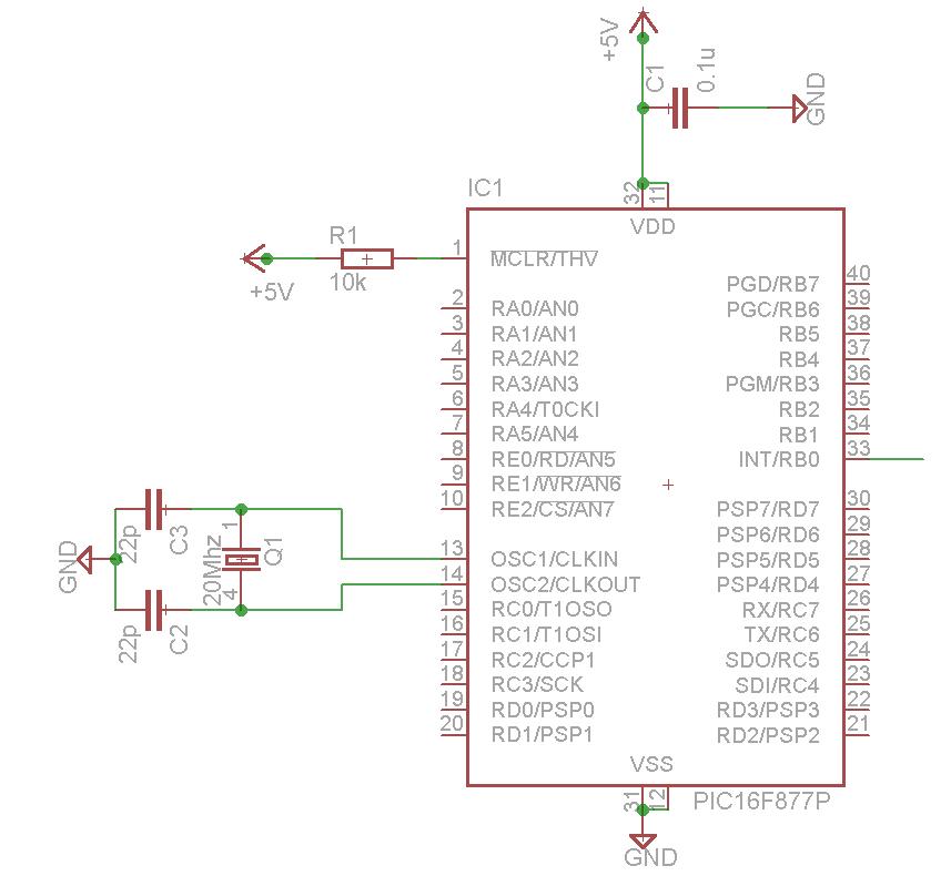

Hello again,
Here is my new diagram I only added 20Mhz crystal and 2X22pf capacitor, I am trying to control a servo motor from pin RB0 of the PIC16F877. Nothing happen, You think my diagram is wrong? or the codes? I posted already?
Thanks in advance
Hello again,
Thanks in advance
You have a pulldown on MCLR. That's backward. Put a pullup - the resistor should connect to VCC/5V.
That might work as long as the programmer is connected, overriding the pulldown, but the second you disconnect it the PIC is in RESET. Nothing happens while in reset. MCLR must go high for the chip to run.

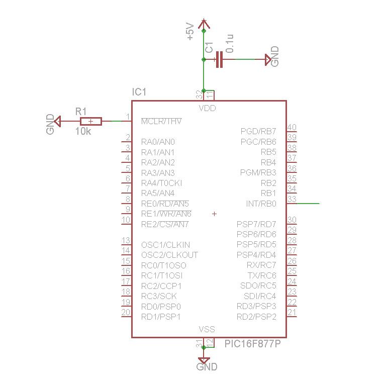

Thanks futz for replying,
Here is the new diagram, The problem now I am reading 5V continuous 5V from RB0 from my oscilloscope? Any idea what wrong?
General Question> why there is 2 power supply and 2 ground in this PIC, can i only connect one of them?
Thanks in advance
Hello again,
Anyone like my new avatar :).
To the main point, the codes and the circuit is fine, I reprogrammed it and now it's working fine I am reading 2ms from oscilloscope :).
