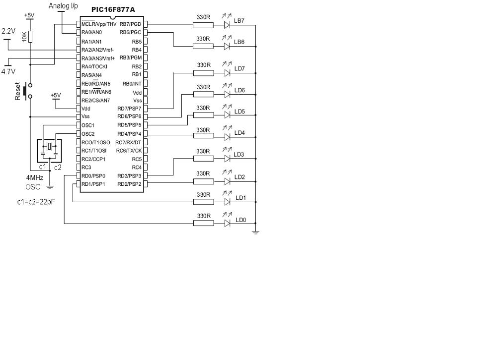

Hi, All. I m new. Hope u can help me.
I compile this program as shown below. Does this program working? It compile in MikroBasic successfully. I just spoil two PIC16F877A. Even simple LED blinking program also couldn't work. Does PIC very sensitive? What causes make it spoil? [When the PIC is running, i took out the crystal oss.Will it spoil the PIC]
What is the MSB and LSB output? does the sequence of value in this way, [MSB] RD7,RD6,RD5,RD4,RD3,RD2,RD1,RD0,RB7,RB6 [LSB]?

ya, one more question.. May i use voltage divider rule (connection of 2 series resistors) to supply 2.2V from 5V?

They are static sensitive. Even if you don't feel the zap yourself, so keep yourself and the work area grounded just to be safe.
Even so, you probably haven't ruined the chip unless you applied power backwards or too high of a voltage. (above 6V)
What are you using to program it with? You may just have the wrong CONFIG word (Also called fuses) set in the programmer. Choose XT for the oscillator type.
Won't hurt it. It will just stop running until you put the crystal back.
I don't use MikroBasic, but it looks like it does according to the comments in the code that you downloaded.
You don't need to supply 2.2V - this is the output from the internal voltage reference.

[MSB] RB7,RB6,RD7,RD6,RD5,RD4,RD3,RD2,RD1,RD0 [LSB]
I think (I don't use MicroBasic) that the instruction
PORTB = word(AnalogInput >> 2)
Will put the 2 MSBs into RB7 and RB6
I don't know why the comments say otherwise.

You need to connect both VDD and both VSS pins of the pic to the power supply, this is not shown on your scematic.
also
1.make sure you add 0.1 uF capacitor as close as you can of your PIC
2.make sure the LVP mode is disabled in your config fuse.
i did connect the both of VDD and VSS to power supply.
Wat r the meaning of internal voltage refrence? Is it writing the code in PIC to give 2.2 V reference?
